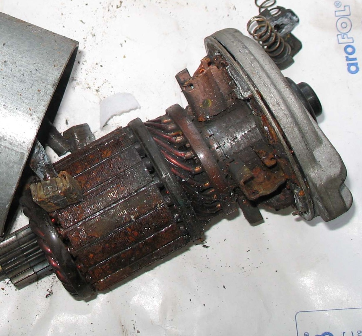

Things are pointing towards a brushes/commutator problem.

The quick answer is yes, new starter motor.
The longer answer, if you have a few tools and a sense of adventure - repair the starter motor.
At a quick guess, the brushes are very worn and not making good contact any more.
If you are lucky the commutator will just need a good clean, rather than skimming in a lathe.
New brushes £10
New starter motor £200 ?
As there are different version of the assembly, I thought I would start at the Renault dealer, but even they weren't sure. A new assembly £269 I didn't even ask about VAT.
Actually the brushes and commutator, have lots of life left in then, but have seized up with rust. So I think a clean and new brushes will be ok. Are all brushes the same quality, or should I go to Renault, I don't want to do this again for along time.

I've re-built the old one and I guess it has 4ish years left in it, so it's in the spares bucket!

If you look at#25 you will see the state of the brushes, which doesn't allow the current to go through the solenoid, my method isolates the solenoid.

Yes, you are missing something!I pointed out that there was no current through the motor when I showed you the photo of the brushes. To test the solenoid the negative jump lead (Or wire) to the wire between the solenoid and the motor and the positive wire to the small connector on the solenoid.
