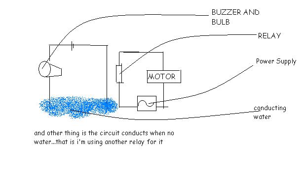

Can you post a schematic (or sketch) of your circuit?
Since you already have "domestic power" available, can you just add a wall-wart to power a relay, and a MOSFET or transistor (or 2) to drive it from your µA source?

i dont want too use transistor here... brief circuit is given below,
not sure of using wall-wart, because it may lead to electric shock??!

Wall warts are safe. They use a transformer to isolate the output from the mains.
Your circuit will never work as shown. There is barely enough current in you water detection loop to turn on a transistor, let alone a relay. As BrownOut said, a wall-wart is isolated and perfectly safe for your purpose.
You may want to Google: water liquid detector alarm circuit
There are tons of circuits that do what you want...and most of them work. ;)

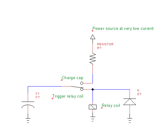

, can i have a simply diagram, so that it will make me understand.
A very simple diagram would be like this:
relay-trigger-png.33241
When the switch is up, the cap is connected to the supply via a current limiting resistor. This slowly charges the capacitor up. When the switch is down, the cap is connected across the relay coil and supplies the needed high current to activate it briefly. A latching relay only needs a short pulse to switch states.

thanx...but i didn get why Diode is used there? as i cant operate a switch everytime the capacitor charges, can i use the following circuit? so that the current flows through relay as capacitor discharges?
