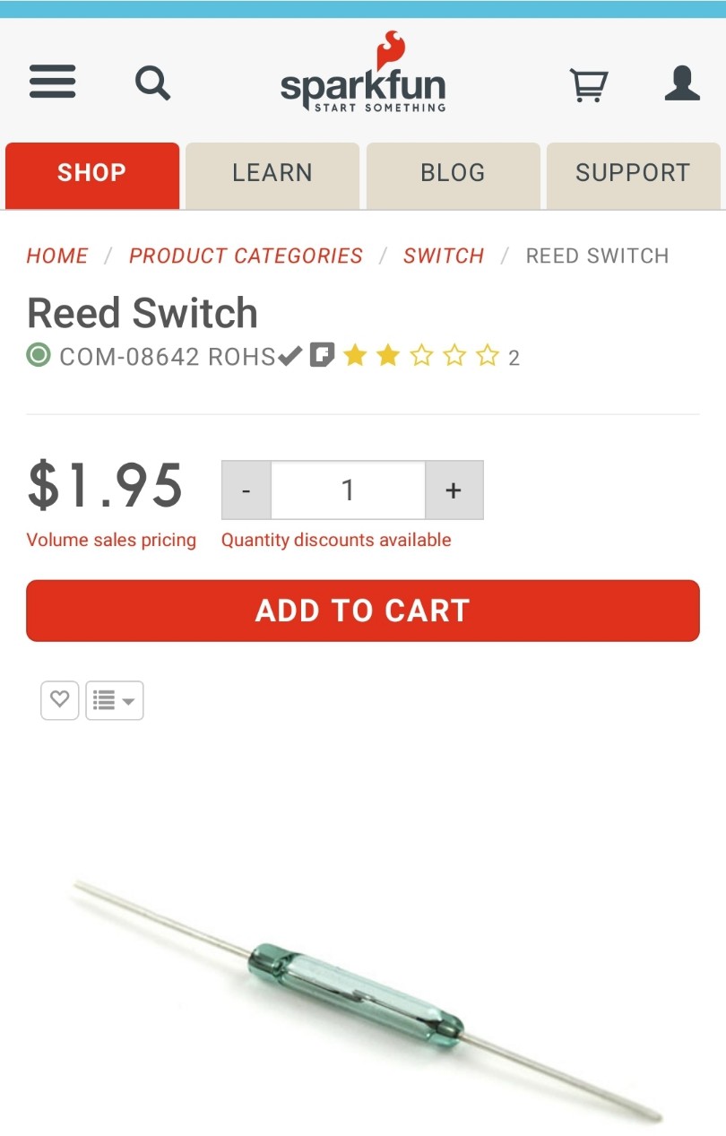

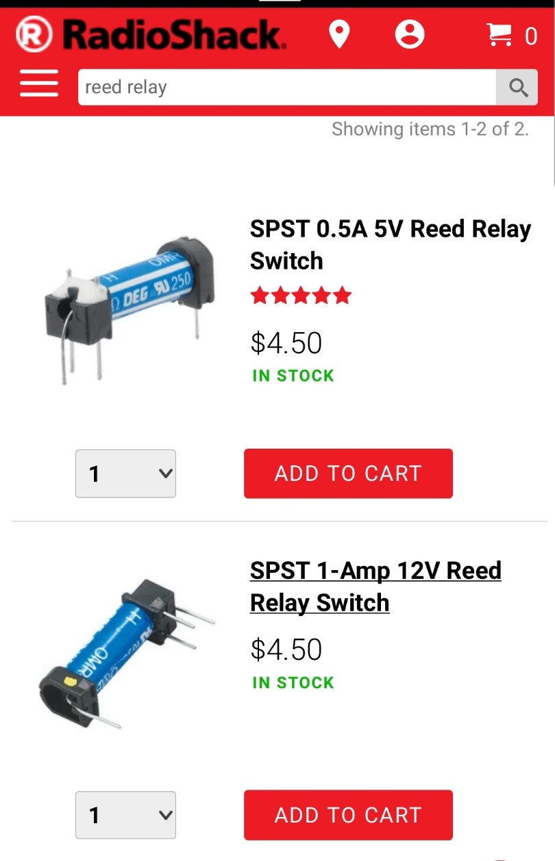

One option, which probably isn't exactly what you're thinking...
A reed relay of the type Radio Shack (still, on-line) sells is a magnetic reed switch surrounded by a coil of wire. The reed switch can actually be removed from the coil without damage to either – I've bought these when I needed a reed switch.
Using a bare reed switch, you can demonstrate how bringing a magnet close will make the switch close. Then explain that the coil creates a magnetic field to do the same thing.
