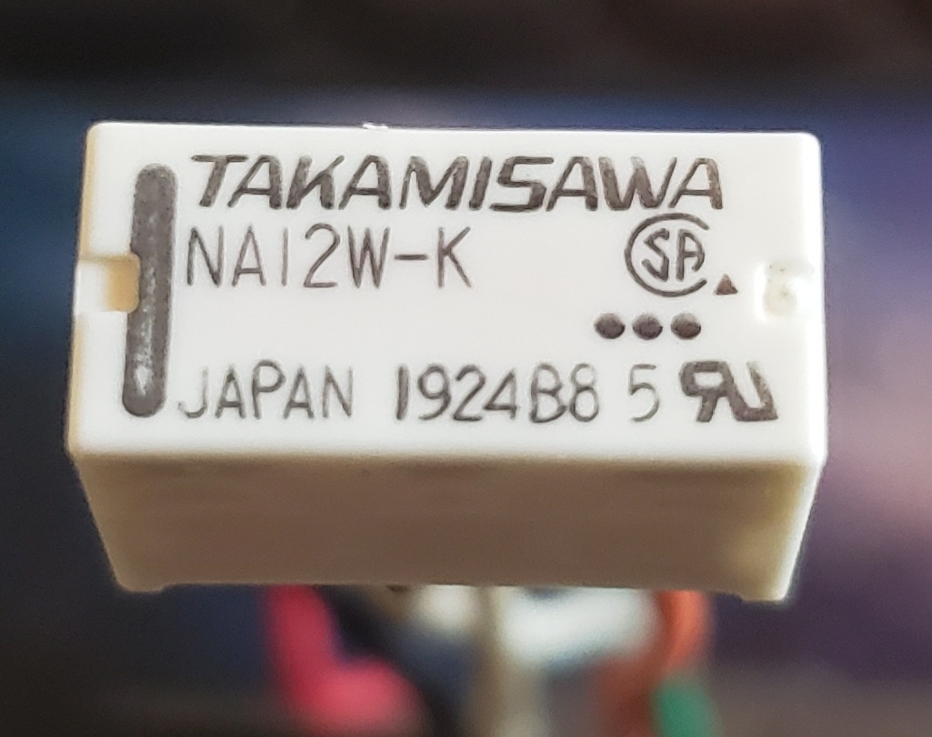

Relay Coil has Polarity?
Follow the indicated polarity, and you won't go wrong. In many cases, the relay may possibly include a diode, and when you order one, you might get that version. If you follow the markings, it won't make any difference.
I recently learned that automotive relays come in a common package, but some relays in that package include a diode and others do not, which is not necessarily marked on the package. Follow the convention and it doesn't matter.
