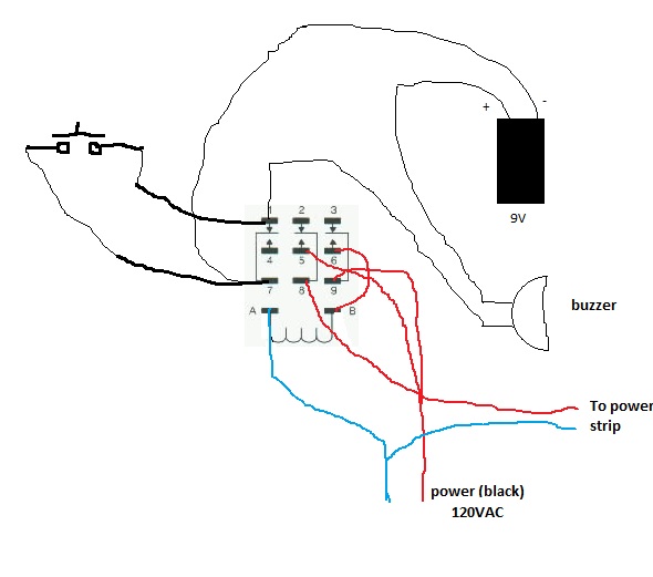

I have a tank filled with water. If the water level rises below a float switch, I want to turn off a power strip. If the water rises above a float switch, I want to turn off a power strip. If the power gets turned off to the power strip, I want to have a buzzer sound and require a button to be pressed to reset the system. The float switches can be either NC or NO. Does this have to be two different circuits? Will I need a small UPS so I do not have to reset everything when the power goes out?
The power stip is currently connected to a standard 15A 120V circuit.
Thanks for the help.

I see a couple of additions: Buzzer silence (on/off) ,buzzer test(PB) and a 9V battery.The buzzer test just verifies that the 9Vbattery is good. It would just beused to sound the buzzer when the power is out.
A 3PDT relay with a 120 VAC coil can do this for you. I'll call the contacts: a,b,c and NO for norm open, NC for NC and C for common.
The buzzer part: Take the 9V battery in series with NC(a) and C(a) the buzzer silence switchand back to the negative of the battery. Put the buzzer test C and NC contact across the relay in the same place as the NC(a) and C(a)
So, when the power is out, the battery supplies power for the buzzer and you can turn it off and test the battery.
Take one of the other contacts NO(b) and C(b) and put it in series with the black lead of the power. You might want to put a cord and and a socket on a separate box. This switces power to the outlet strip.
Route always on line power (black) to C(c) and NO(c) to one end of the coil. Connect white to the other side of the coil. Now,if wecan get the relay to close,power stays applied to the relay.
Wire the NC contact of a switch (OFF), if desired, in series with the above, Pushing this button will open the circuit nd drop out the relay. Also put your float switches here. What you want is the contact to open when you want the relay to drop out.
Now wire a NO pushbutton across the NO(c) and C(c) above. This provides a means of initally closing the relay.
The relay will automatically drop out with a power failure.

I attached a file with what I believe is the pinout for a 3PDT. Using the write up below, what would be connected to each number?
It is. The coil is pins A & B. There is no polarity for an AC coil.
Think of the coil pulling the horizontal bar toward the other pointy arrow. So the arrows are either the NC or NO contacts. 7,8 and 9 will be the common pins. Since 7 is shown touching #1 and #7 is common to both of the arrows, it's a common terminal to #1 and #4. Since #1 is touching the arrow,that contact will be a NC or Normally Closed one. Pin#4 is the NO or Normally Open contact. #1, #4 and #7 make up the equlivelent of an SPDT or single pole double throw switch.
You can arbitrarily label the colums as a, b and c so #1 is NC(a); #4 is NO(a) and #7 is C(a) etc.
Okay so I started putting a diagram together, but I am not sure where the float switches go.

You need a push button similar to the one you've drawn between pins 9 and 6 to arm the relay. Once you push it, the relay will stay engaged.
You need an on/off switch to act as a buzzer silence, if you want it in series with the battery.
You need to insert your float switches into the B to 6 wire. When you momentarily open this circuit, the relay will drop out.
Do I insert them in series or parallel? I assume they should be NC?

You said drop out when Float 1 is below level 1 and another when float 2 is above level 2.
What this means is when when the level is correct, the floats should be closed. This may not be the NC contacts.
So, when the levels are correct, place the closed contacts (based on when the level is correct) from the floats in series.
Make sense?

The point would be that if the fluid level is correct, the float "switch" would be off. By not passing any current the relay drop out. If I ran them in parallel then they would need to rely on each other to drop out the relay, however in series they run independent of each other. Correct?
Ok, another comminications issue. Float switches can be Normally open (alarm applications), Normally closed (overflow/drop aout applicationsor both (An SPDT switch).
Lets suppose you had an SPDT float or one NC and 1 NO contact. Open means unactivated at rest. Closed with full water like in a toilet tank.
In This case:
If no water, then both switches would be open.
If water at above the first level, but below the second, then bottom would be closed and top would be open.
If above the second switch, then both switches would be closed.
So,this scenero, creates a problem. In the upper switch, you would need to use the NC contact then.
Below first level, bottom would be open.
Between levels top and bottom would be closed
Above top level, top would be open
So, if they are wired in series properly, then either switch (above top) or (below bottom) would open the circuit.
If your switches are the wrong type you can use another relay to invert one of the outputs.
This page: https://www.electro-tech-online.com/custompdfs/2010/12/an-mc-004.pdf kinda shows what you have, but not exactly.
You can replace the 24 VDC power with 120 VAC and remove two phases and it's almost what you have.
The || and the |/| are separate Normally open and Normally closed contacts. In his word, they don't share a common point.
You can think of the |/| contact 95 & 96 as where your float switches go. Two of them. e.g 95----| |----| /|-----96. the first being the level 1 switch (below level 1) and the second being the level 2 switch (Open greater than level #2)
