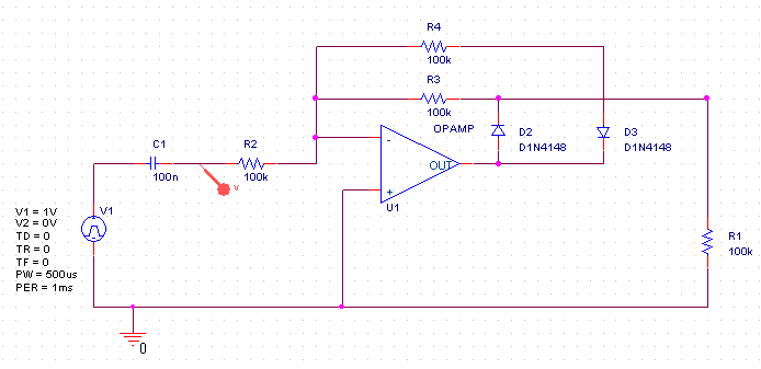

I've tried running some simulations on PSpice but I'm stuck at generating a good (conditioned) signal for the sensor. The problem is the coupling capacitor which is blocking DC but at the same time it distorts the square wave signal. If the cap value is small then it distorts more and if it's large the time constant becomes large itself and hundreds of miliseconds pass before it becomes stabilized at 0DC - the sensor doesn't want that. Even so there's some distortion and the signal itself isn't symmetrical (there are a few tens of millivolts difference between the peaks). Is there a specific method for removing the DC component of digital (square wave) signals without any losses to the signal itself?

Hi. If you are running your source signal through a capacitor, there can be no DC component on the other side of the capacitor. Your simulation is likely starting off with an initial charge on the capacitor that degenerates in a few milliseconds and would not be there in the real world.
Distortion of the square wave is acceptable. You want to measure the peak voltage. Naturally, the capacitor will distort the square wave because it is acting as a low pass filter in conjunction with the sensor resistance.
If the square wave does not have a 50% duty cycle, there will be a voltage difference between the peaks with respect to 0v. That is what you would expect from a signal with no DC component on it. If the signal is high for x seconds and low for X+1 seconds, the high peak would have to greater in amplitude (with respect to 0V) than the low peak to balance out the longer, low peak.
If you want a square wave with no distortion and no DC component, you would have to generate it directly at the source, but it will get distorted after passing it through the sensor anyway, because the sensor has a quite large internal capacitance. If you fed the sensor with a sine wave, the sine wave would not get distorted. Again, though, you want to measure the peak voltage, so the wave-shape is not critical.
It seems the sim isn't aware of that :) Here's my circuit and the results of the simulation (the ideal diode does its job, only problem is the square wave signal). I don't know if 25mV are enough to trigger electrolysis in the sensor but all the datasheets I've read so far seem to emphasize the necessity of a symmetrical input signal.
The capacitor in series with the signal is the correct way to remove any dc component. It appears to take a long time to stabilize in PSpice with a larger capacitor, but a few hundred milliseconds is no problem in the real circuit, since that only occurs at start-up and you will likely be applying the signal for many seconds at a time.
A small amount of distortion of the square-wave is not a problem. The high-pass filter formed by the cap and resistance will cause some droop in the flat-portion of square-wave but that won't significantly affect the measurement.
And even if the waveform is not symmetrical, the capacitor insures that the net dc current is zero, as required by the sensor.
There will be a slight DC offset in the real world with your circuit in the last post at the point where the red probe is because the op amp is not perfect. It has its own offset and input errors. It may be a good idea to put a capacitor after the sensor, as well as before it.
How will a capacitor after the sensor help? It will have no effect on the op amp errors and the dc average voltage at that point is zero.
It won't help. The humidity sensor is in the series arm of the device, not the thermistor. Forget what I said about a capacitor after the sensor. It's won't help and is totally unnecessary.
In your simulation, though, you may see an op amp error offset where the red probe is. You can ignore it, but still understand why it is there.
It works! :)
Even with a small capacitor the DC is gone and the square wave isn't distorted at all. Now I'll just have to get another opamp since I fried it (I seem to be doing that a lot lately...) while trying to construct the ideal diode circuit and test it with the sensor.
