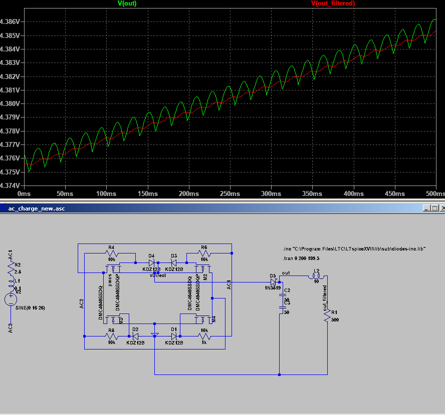

I have a current limited power supply driving an active-rectifier which will operate a PWM to charge a super-capacitor. In the attached circuit the PWM has been replaced with a diode but the principle is the same (say 100% duty cycle).
Because the super-caps overwhelm the power supply the voltage increases steadily up to 5V at which point the PWM will end. At around 4.5V the power may enable to a USB device and since there's no inductance on the output, that's where the fun starts.
According to LTSpice the ripple is minimal but when I built it in real-life at around 4.75V the USB device I had attached (a Garmin) had visual issues and crashed. I believe (I'm awaiting a new oscilloscope to verify) that the ripple when the capacitor reaches saturation point is greater than simulated. I haven't built it with a PWM yet only using a diode, but that's my theory.
As the AC frequency is low this requires a very large inductor (10H as shown) to smooth the ripple. I'm not an analog engineer and do wonder if there's another way?
Regards,
Andrew
Not sure what you mean by saturation point of the capacitor, but...
Do you not have a capacitor on the output side of the inductor? A large inductor next to the load without a sufficiently large capacitor is going to cause the load to experience huge voltage drops whenever there is a transient current increase causing brownouts and such. Conversely, whenever current demand suddenly drops you're going to get a voltage increase that the cap needs to be there to absorb or in worse cases suppressed or clamped because it's basically inductive flyback. Basically the transient response of your power supply is too slow and there is insufficient decoupling.
You would not see this in the simulation since you are using a static load rather than a dynamic one. Replace the load with ...I don't know...two resistors in parallel with each other where one resistor is in series with a switch that is constantly switching on and off and watch the voltage dip and spike rather than maintaining that nice ripple you originally saw.
But if you want to filter out ripple, have you tried using a multi-order LC filter? Where you just chain a bunch of LC filters together? You can get away with smaller inductors and capacitors if you do that. You just have more of them and the dropoff should be higher than if you throw the sum of all those Ls and Cs into a single order LC filter.

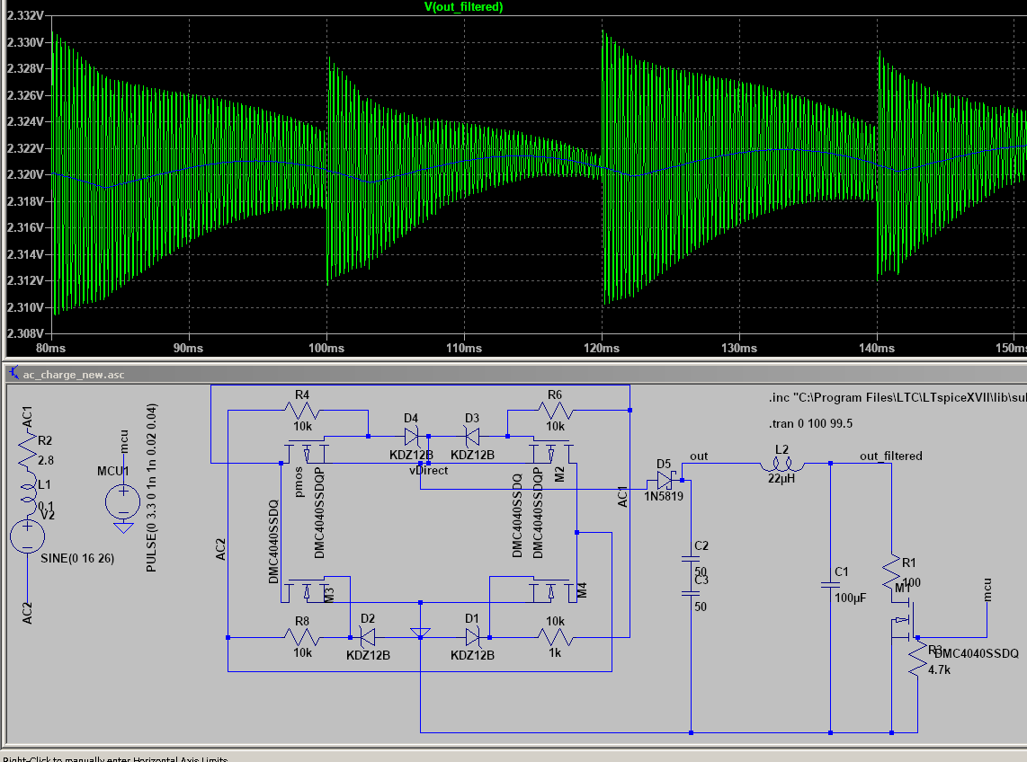

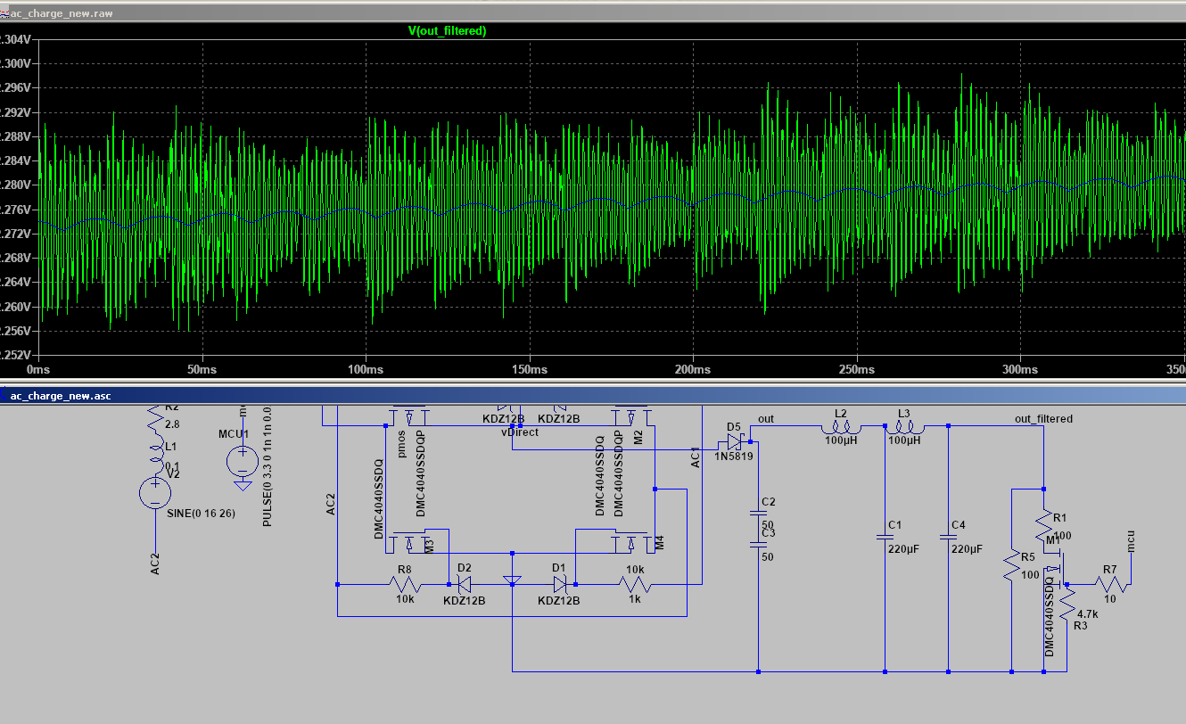

I was only running something small as a tester, probably 22uH but it fried it anyway. I'm a bit lost here, I get very little ripple without the inductor but the Garmin crashed so something's up. Adding the LC seems to be adding ripple. Perhaps it needs the oscilloscope to see what is really going on.
Well, part of the reason is your L is much lower than what you had before so that's to be expected. Also, now you appear to have a dynamic load so that's to be expected too. Put a equal value resistor in parallel with your dynamic load so it's a bit more reflective of something real. It's pretty harsh for a load to just suddenly draw no current momentarily.
It could also be resonance of any LC filter you put into the circuit which is one "gotcha" of using LC filters.
But do you even need the inductor there to begin with? It may not be necessary depending on what you're after.
