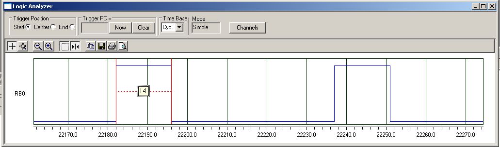

Here is my RC-5 Code. It will send all info correctly except for that toggle bit aka control bit. It will always send one cuz i havent coded that in yet lol but this will send the data correctly since i tested it in the logic analyzer. i thought id put the beta online for all to see. The delays are modded to fit with the cycles used before the calling of them. meaning a 7uS delay is not actually 7uS its less since it takes time to get called.

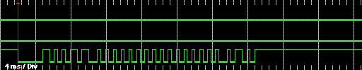

The image is the IR DATA from my remote. Can anyone determine what kind is it.
The below code is my RC-5 Remote code. Not useful to me anymore since i know mines isnt RC-5 lol but it might be usefull to others.

NEC IR Code Format Looks like what you have I guess your not worried about
What sends your Modulated Carrier
your just catching the code look here **broken link removed**
i dont know if its NEC. I tried to check it against it and if i do it by hand:
vol up sends: 8, 1, 1, 18
vol down sends: 8, 1, 1, 9
No inversion there. Its funny lol

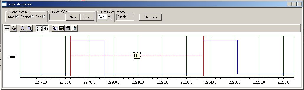

not enough info there. I always go there :D I need to know the length of the individual pulses.
For RC-5 its 27.8uS for 1 pulse. Where 6.95uS the pulse is high and 20.85uS the pulse is low.
Not sure if its me but some how that doesnt seem correct.

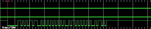

SB-Projects has never been wrong for me and they state:
The protocol uses bi-phase modulation (or so-called Manchester coding) of a 36kHz IR carrier frequency.
on the other page it says 38.4khz
I have seen it from 36 to 40 and higher i don't think the carrier frequency is that important. The carrier frequency only matters to your Ir module they look at any thing out of there frequency as noise. That why Ir modules are no good if you don't send them modulated Ir
This is the only real thing different
Data is modulated using Manchester coding. This means that each bit (or symbol) will have both a mark and space in the output signal. If the symbol is a "1" the first half of the bit time is a mark and the second half is a space. If the symbol is a "0" the first half of the bit time is a space and the second half is a mark.
Please note that this is the opposite of the RC-5 protocol!

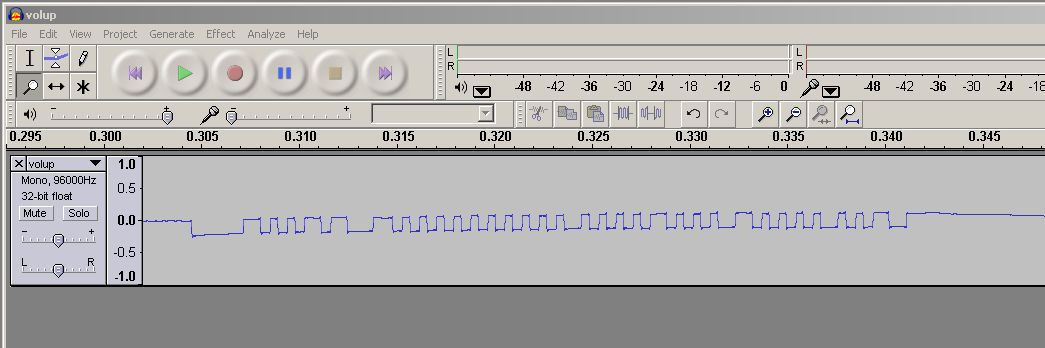

Where you get the program you used the volup
its freeware audio application called:
Audacity
i connected the IR part to gnd and 5+ and the signal to the right channel of headset and Gnd
since RC-5 and RC-6 are so similar. Can i use the same: 27.8uS pulse?
RC6 is just an extended version of RC5, both use exactly the same Manchester coding - essentially RC6 gives more scope for expansion, more device codes, and more command codes.
As suggested, the actual modulation frequency makes little difference, as does the precise pulse width - the whole point of Manchester coding is that the pulse width isn't important, it's the change from high to low, and low to high, that carries the data, and not the pulse width.

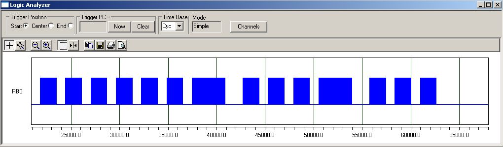

heh here is the code i have so far. Untested not sure if it works at all lol but it makes a nice form on the Logic Analyzer in MPLAB:

This is the actual data:
data-jpg.28915

The below 14 in uS = 7uS .
pulsehigh-jpg.28918
The below 55 in uS = 27.5 uS
completepulse-jpg.28917

PICKit2 logic analyser
Having a few spare minutes, I threw together an IR receiver to feed to my PICKit2 (IR receiver IC, 47Ω, 47µF), and here are some sample remote signals.
They are all ON/OFF signals, the first two are from satellite TV (Sky) boxes, a normal Sky box then a Sky+ (PVR), notice the slight difference because of the different device ID. These both use Philips RC6.
The third one is Sony SIRC's, and is a nice simple system to read, which was why I choose it for my tutorials.
