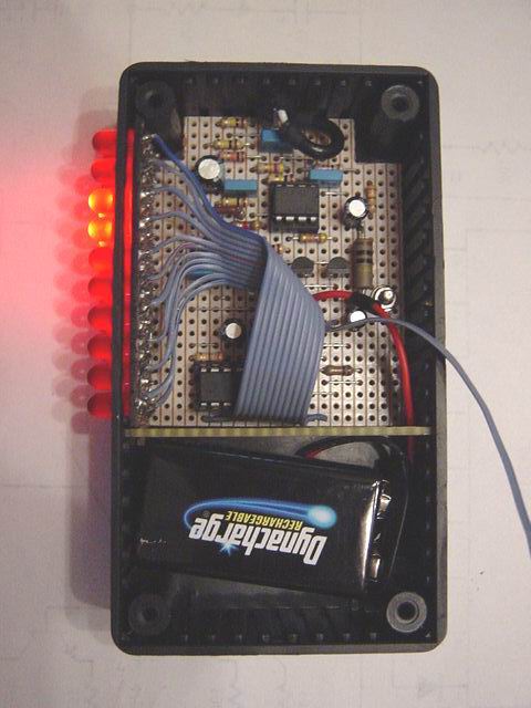

My Sound Level Indicator project has one and it is charged continuously with a 390 ohm resistor from a 9V/300mA wall-wart.
https://www.electronics-lab.com/projects/motor_light/009/index.html

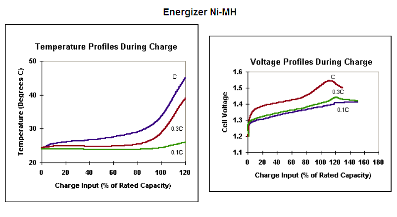

From what I remember, NiMH were one of the trickier batteries to charge. They aren't "supposed" to be trickle charged, and the only other methods of charge detection were temperature based and voltage based. The problem was that the "delta V" effect was much smaller than NiCd cells, so temperature measurement was the easiest way of terminating charge.
Yeah, NiMH is a bit weird. You can either have voltage peak detection or thermal peak detection to signal the charge cycle is complete, however I have been lead to believe that the temperature increase of the NiMH is responsible for the peak in voltage. My charger manual says (and I have read a few places) that charging NiMH with a very low current will cause trouble in detecting the peak because at such a low charge current there is not a noticeable increase in temperature. But the charger has no temperature probe for the batteries so I can only assume it uses voltage peak detection (also says so in the manual). So I think the temperature increase is required for the voltage peak to occur. Does anyone know more about the relationship between NiMH temperature and voltage peaking?
It is detailed in Energizer's Applications Manual.
