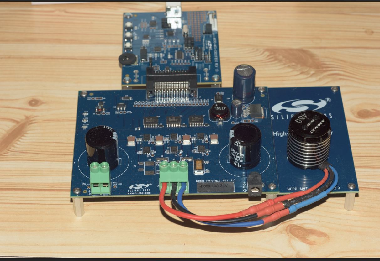

Your right! Give me a couple of hours so I can go dig the board back out and I will post a pic. I didnt run the numbers so there is two options.
1) Silicon Labs now own the HOLY GRAIL of all our power needs.
2) I have read a label wrong somewhere OR made some other mistake!!:confused:
Who would of thought Silicon Labs would come up with that!!!:joyful::joyful: (Well its better than option 2!)
EDIT
There is a pic of the board on my desktop!! So here it is :oops:.
my only defense is I gave the numbers from memory and before my glasses! I was sure it was 14V. At least I got the 4 right :D, I better check the PSU that powers it!! In the unlikely event I *may* have been myopically challenged when I read it the first time
The board isnt being used, so I could drop to 10A and 12V. I related it to the board for other reasons, but clearly I messed that up!

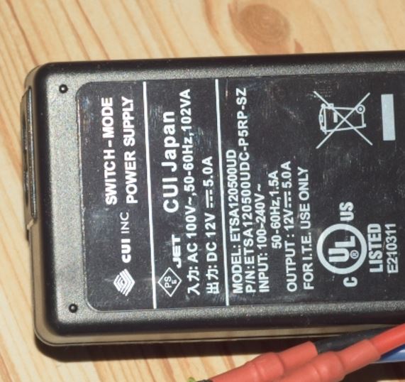

Ok something very wrong! here is the psu for the board, note the board isnt relevant to what i want to do as such. So I will ignore the board for now, but when I get a chance I am going to see whats going on with the board, I havnt ever measured it I took the labels at there word. Maybe its a max rating but I would expect it to say that??
EDIT NVM I spotted the label! Didnt notice the input ;), and the output being related to the 100V input. I assume the output at my voltage is 24V and 10A.
The board isnt being used and I wasnt paying attention, sorry the board is a complete red herring and I am a myopic idiot!!
Best solution to the above pics is a marker pen on certain bits and declare silicon Labs geniuses!! Everyone agree? So Over unity does indeed exist and the photoshopped pics I do later will prove it :D
The output is fixed at 12VDC @ 5A for any AC input of between 100VAC and 240VAC.
Then that makes no sense!
You can see the board, the board output is 24V 10A the way it would make sense is if the 12V 5A was related to the 100V input. Now I am going to have to waste time measuring it lol or it will drive me mad!

Hi LG,
Taking the picture of the PSU in isolation and forgetting the apparent anomaly for the moment, tronitech is right. That power supply has a 12V 5A output regardless of the input voltage. The label is confusing, but that is nothing new. The lower information is for UL registration and would not necessarily make sense from an electrical theory point of view. That is certainly an off-line switch mode power supply typical of laptop PSUs. Its maximum output power is 12V * 5A= 60W and, assuming a typical conversion deficiency of 80%, would give a maximum input power of (100/80) * 60W= 75W.

It needs UL and Japanese labels. Some areas of Japan has 100 V mains.
So 12*5 = 60 VA
It's 105 VA at 100V. So, you have a 60/105*100 or a 57% efficient power supply.
The supply can deliver 5A at 12 V. There will be a plot of efficiency vs load.
Efficiency at the max designed output is a good spec to start with. The no load Wattage would be another good spec to publish.
It needs UL and Japanese labels. Some ares of Japan has 100 V mains.
So 12*5 = 60 VA
Not necessarily true. The input voltage and current stated on labels are not necessarily concurrent and are not intended to be used to calculate efficiency. They are normally worst case values or other criteria.
