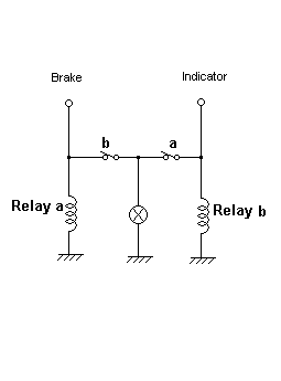

Klaus' circuit gets my vote !
It took me a while to get my head around this, even after drawing it,
I was convinced some steering diodes would be required, but no!
This should work just 'as is'
Any car junk yard will yeild a fist full of relays that can do this, or an auto factor shop.

Klaus, I like your 2-relay circuit/solution.
1997GA16DE, something I'm confused about ... if you press the brakes, the light goes on. If you turn the blinker on, then the bulb flashes. If you do both, the bulb still flashes, but 180-deg out of phase with the blinker signal. Any reason for the out-of-phase requirement? I'm wondering why not just state the design as blinker takes priority over the brake? This would eliminate the XOR requirement, though the solution may not be any simpler that those proposed. Just curious.

correct, the rear blinker will be flashing opposite to the front blinker bulb, but only when I have the brake pressed. I agree it would be better to have it flash like normal all the time but that would require more work than I'm really up to doing (the blinker's signal is not constant and there is nothing on it that is constant except at the switch). Nevertheless, it still blinks and that's all that matters to me (and the policia).

ok, I almost got this done. Here's what I decided doing:
this will cancel the brake signal when the blinker for that side is on, the blinker signal can take over illuminating the bulb until I turn off the blinker switch.

From the diagram, you appear to have 2 relays in series. Therefore, they should be 6V relays, not 12V. If you use less than the rated voltage on a relay, you can have problems of unreliable activation.
ok, what do you recommend from here? I don't have any other relay. All of th relays are the same, they ar the 5 point relays that are both N/c and N/O.
The recommodation is very simple, you don't connect relays in series.
Instead, connect them in parallel then they still operate both at the same time but each gets the full 12Volts.
Connect on coil side of EACH of the 4 relays to ground.
Connect the other coil side of each PAIR together and then to L or R of the switch.
Klaus

yea, I just did that. Yesterday, I was thinking about it and I said, I could just split the incoming signal and have each go to one relay (or parallel). I was like "..duh".
