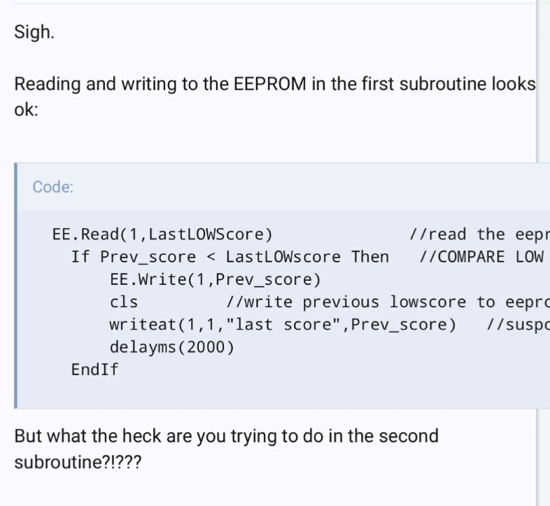

Reading and writing to the EEPROM in the first subroutine looks ok:
  EE.Read(1,LastLOWScore)              //read the eeprom
    If Prev_score < LastLOWscore Then   //COMPARE LOW AND PRESENT SCORE ON EEPROM
        EE.Write(1,Prev_score)
        cls         //write previous lowscore to eeprom
        writeat(1,1,"last score",Prev_score)   //susposed to show what Prev_score is (write to eeprom
        delayms(2000)
    EndIf
But what the heck are you trying to do in the second subroutine?!???
I am LOST

You have two subroutines that both read and write to the EEPROM. My replied stated that the first subroutine does this the right way and the second is rubbish.
Follow the exact same form reading and reading to the EEPROM that you used in the first subroutine and it will work fine.
The bigest error (logic) is setting the initial value to zero, nobody can ever get a score less than zero!
I'm reasonably sure you can't get a score lower than zero!
If it initializes to 32767 it might work. Not holding my breath.
