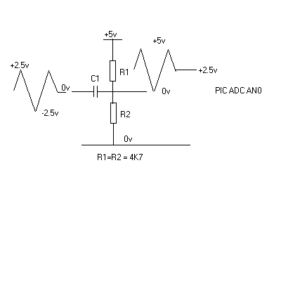

Ok, for example. The ac signal is swinging from -2 V to +2V (say), but the analog input of the PIC is Vss-0.3 V minimum (if I remember correctly). So in order to get the correct samples, you have to shift up the signal, to make it say from 0 V to 4 V, so that the PIC can sample the whole range of the signal.

Could you please advise me on how to shift my signal, say ,I am using -1 to +1 V? Is there any circuit to design, If so, then any guidance on that!
I will really appreciate all the help!
Thanks again.
Dear Nigel,
I am very thankful for your suggestion. I had a look on this forum for about 4 hours and found 1 reply by one of our members explaining the diagram [ image attahched with this reply] . I am a bit concerned about using this setting. Which values of R and C should I take??
If you see my first post, I have to perform the peak hunting of the signal as well. Do you think this technique will not affect my actual magnitude value? [ Obviously In this case I am using a -1 to 1 V sine wave, but in my project, the wave is going to be an unknown value i.e. little bit less than -1 to 1 V

Nigel Goodwin said:
Component values are dependent on impedances and frequency range, as your's is 1KHz you shouldn't require a large capacitor.
Thanks again. The output from my mixer is giving me 1kHz signal all the time. It's 50 ohm impedance. Is there any formulae to calculate these values
at say -1 to 1 V? I am very much struggling in finding this :|

If R1=R2=100 k:eek:hm:, so R1//R2 will be 50 k:eek:hm:. Use the capacitor that has the reactance of 50 k:eek:hm: at 1 kHz.

I am thinking of using two 4kohm resistors and thus 80nF capacitor with it.

I would suggest using two 4.7K resistors, and a 0.1uF capacitor - that should work fine, your 50 ohm output impedance makes life easy.
