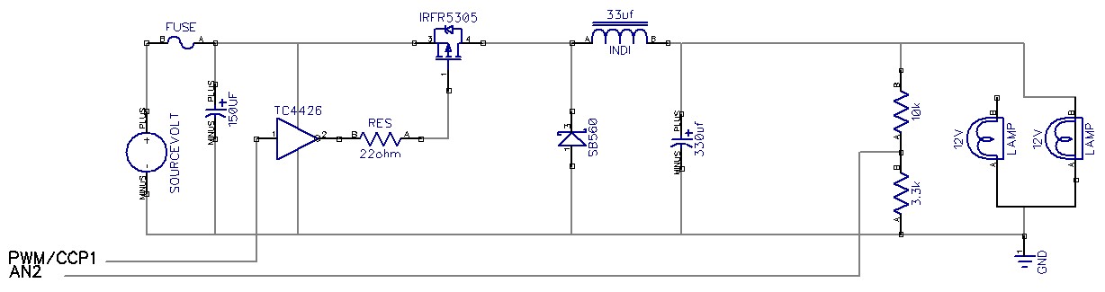

Well there has got to be an easier way to get from Diptrace schematic to jpeg, or gif or something that will show up in attachments. Printed to pdf which comes out decent. Tried converting to jpeg, and it was terrible looking! Tired of messing with schematic stuff.
Anyway, here is the basic setup on the buck converter. The input will soon be a solar panel rated at 17V, 4.4A, and the output load a 12V RV battery. Using a power supply and car tail light for the time being.
The circuit seems comfortable at 34khz, as higher frequencies reduce the desired output voltage. That's the weird part, as I wouldn't think frequency would have anything to do with Vout. My impression was that the duty cycle would drive the Vout, not frequency. Any suggestions for improvements or things to try? Kind of stuck with the inductor at the moment, but will be ordering more parts soon if given direction.

To get the image from Diptrace (or whatever program) just press printscreen, then open up any image editor program and paste->new image. It captures whatever image is on screen, then you can crop it neat and save as a .PNG or .GIF etc.
Your circuit looks ok, to drive lamps. But driving a large 12v RV battery from a buck converter is a very different situation. You can't just regulate output voltage like in your schematic!
The way I stabilize my feedback readings is to time the sampling of the ADC to the PWM output. This way you are reading the same position in the inductor ripple every time. Best would be to do the sampling just before the PWM fires again so you're not reading the middle of the inductor ringing.
