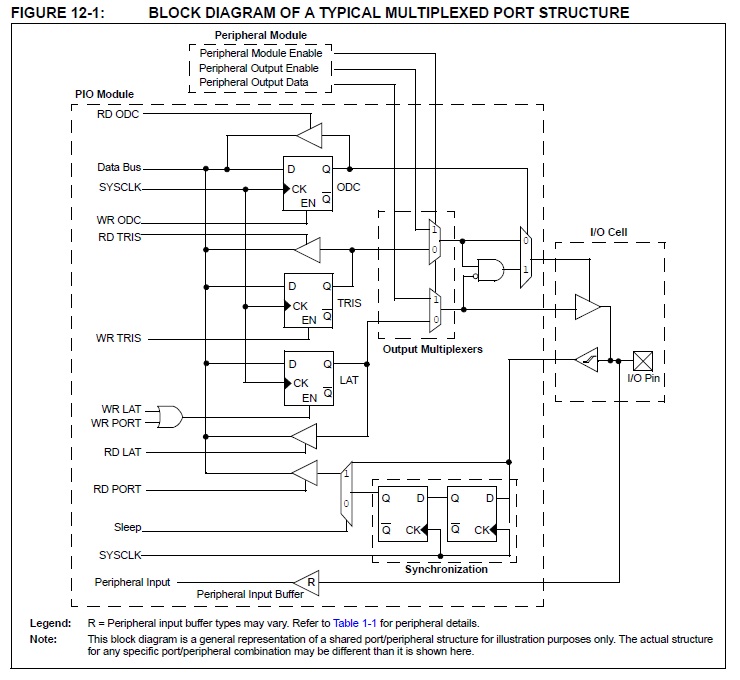

I think in almost every case a PIC still allows "reading" a port pin, even when the pin is assigned to a hardware module. Many of the early PIC asm projects relied on this feature.
If you check the PIC datasheet under the "IO ports" chapter it usually shows the hardware diagram for a port pin. In most cases there is nothing to disable the port pin read function, although on some newer PICs they may disable the digital input reading if the pin is set to analog mode (which it would not be).
Does your PIC32 datasheet have a diagram for that port pin?

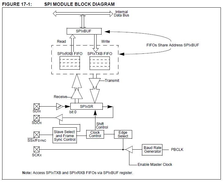

Hi Roman thanks for your reply, I didn't think of checking the pin diagram.
The closest thing I could find was an SPI Block Diagram which doesn't specify what the SDO pin does apart from the SPI functions.
All else I could find in the datasheet is:
In general, when a peripheral is functioning, that pin may not be used as a general purpose I/O pin.
However of course you can't use the pin as an output (for example) when the SPI module is enabled. I guess the best I can do is try it later tonight and let you guys know if it works.
EDIT: Found the diagram you were talking about:
It seems to say that reading the port will work fine while another module is enabled (I think). Cheers mate.
Thanks for the second diagram Gobbledok, that's the one that shows the input function although it's a "generalised" pin.
It looks fine, reading the port pin should read the digital level on the pin at the instant the read takes place. That's pretty standard, even if a pin is an output or a hardware module is driving the
pin.

Im not sure it's a matter of "curiosity" as the PIC pins were always designed so the PIC can read a pin even when it is set to be an output pin.
When hardware output modules are enabled the normal pin output drivers are used so the pin can still be read.
The closest thing I've found to an exception is one some PICs when the pin is set to be "analog input" it can disable the digital input driver (probably to avoid input latch up excess power consumption etc as mentioned in the datasheet).
