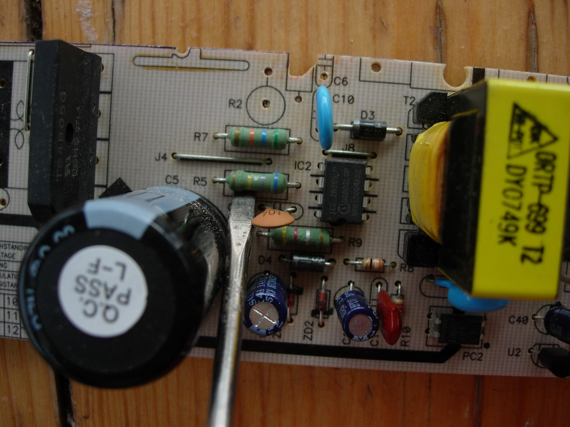

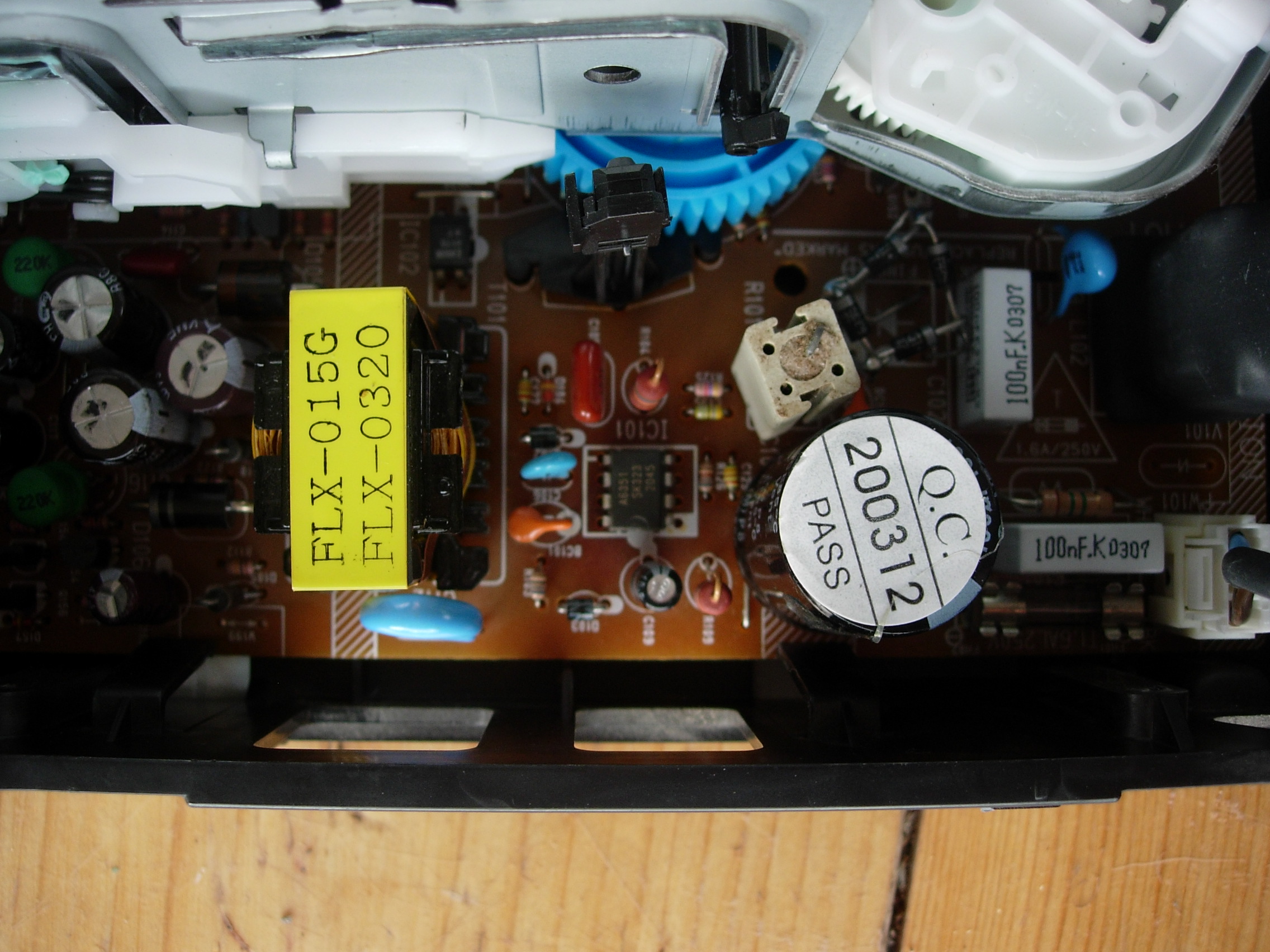

It does help if you post pictures of the power supply (these pics taken with a very cheep 2nd hand camera using Macro feature). One pic is a LG VCR other is a SMPS using a ICE2B265 chip. The R5 690K resistor is the kicker resistor that gets the osc going. These pics are just for an example.
