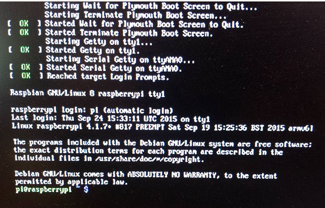

Command line mode is like DOS on a PC.

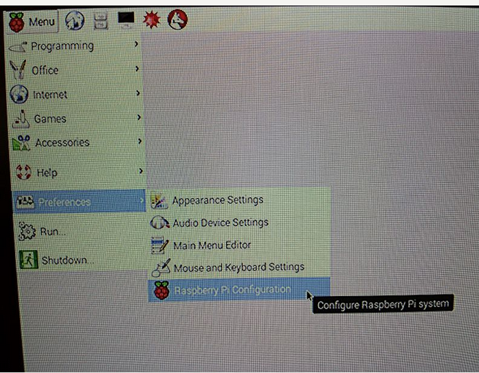

If you do connect a monitor you can get this:
Sorry for the bad pictures.
