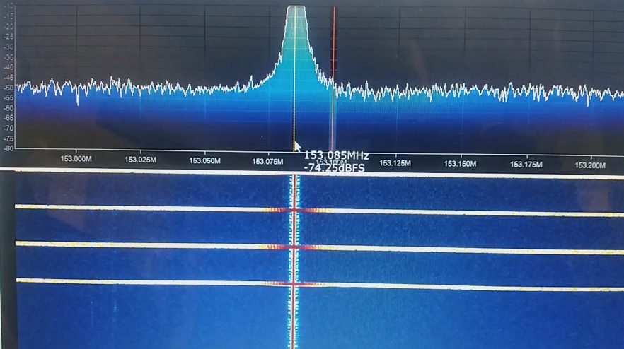

This is likely to be my first and last thread on this forum. This is a cry for help as I'm currently at a loss as to how to proceed with this issue. I've no experience with radio comms and I'm struggling to get a satisfactory solution from our supplier so here I am asking for help! Anyway, enough of the sob story and on to the problem:
I work in the education sector and at one of our sites we have a number of electricity meters which send data wirelessly (via radio transmission @ 153.1MHz) from each of the main buildings to a central hub located in the centre of the site. We had been successfully receiving data daily from all of these meters for at least 2 years. Then, one day in October last year, all of the data suddenly stopped being recorded by the hub. Naturally we assumed the hub was faulty as this is the common point of failure and so it was replaced but to no avail. We have since found that there is some background interference at around 153.085Mhz that appears to be preventing our metering equipment from operating. From the graphs produced it is clear that the interference is constant - it does not pulse, it does not drop, it just exists permanently. I do have some video showing the signal - if it is likely to be of use please let me know and I'll be happy to upload it.

The walkie talkie used was an ICOM IC-R20. It has a simple signal bar to indicate the strength of the signal. However, as the signal bar remained at max for the majority of the survey it was of little use to give a really clear indication of where the signals were coming from. The site is approximately 300m across and the only time the signal dipped was around the boundary of the site.

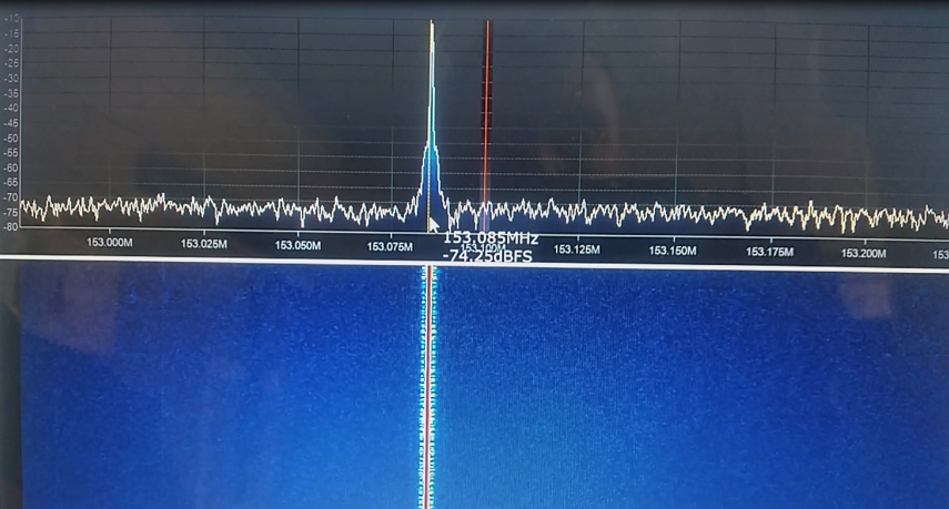

The software used is called Airspy and it yes it does make use of an SDR dongle. I have attached two screenshots from the video I took of the software in use.
The first photo below shows the 'interference' we're seeing. This was constant throughout our 1-day survey and we believe this has been the status quo for the past year or so. As you can see, there is a spike at 153.085MHz which our supplier believes is not related to the metering equipment installed.
The second photo below shows how the software responds to a total of four pulses that were produced by the engineer holding one of the metering transmitters close to the dongle and forcing it to transmit. As you can see, the signal intensity increases as the fourth pulse is recorded. The lower, time based graph, shows each of the previous three pulses as a very obvious horizontal line. The fact that none of these pulses are being picked up by the main hub on site leads us to believe that the background signal shown is causing interference.

I have an Airspy connected via USB to a small Win10 Tablet computer running SDR#. With a small Yagi antenna, the thing is quite portable. I can go walkabout with it to track down the RFI emanating from the latest piece of Chinese-crap-electronics that has been imported to the neighborhood. I suggest you try the same, either with the R20 or the AirSpy.
You might find the birdie is being radiated by the computer you are running the Airspy from. Walking around with a portable setup will quickly dispel that, as would being able to rotate the directional antenna.
