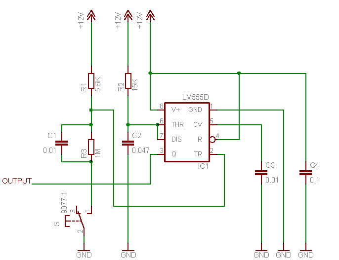

Decisions, decisions. Let me give you something to worry about. :D It is not really different from what has been suggested, except it uses the venerable 555. The original circuit is from an MIT link that is now broken. This gives a positive pulse with a negative (N.O.) input.
555pulse-png.52885
Obviously, the component values can be modified to give whatever pulse width you want.

Yes, I know, a monostable is the other way to go. I want to build both of these into my project and "race" them to see which is better at switch debouncing.
The advantage of the Schmitt trigger solution is, of course, simplicity: I can debounce 4 switches with a quad inverter, where I'd need 4 555s (or 2 556s).
Hey, there are lots of ways to do it. I was just givin' you a rough time. Go with the simplest. John
No, no, your suggestion was much appreciated. It'll be interesting to see which method gives the best results. The raw pushbutton output is really, really flaky. Cannot drive my circuit (3 flip-flops) with any kind of reliability.
