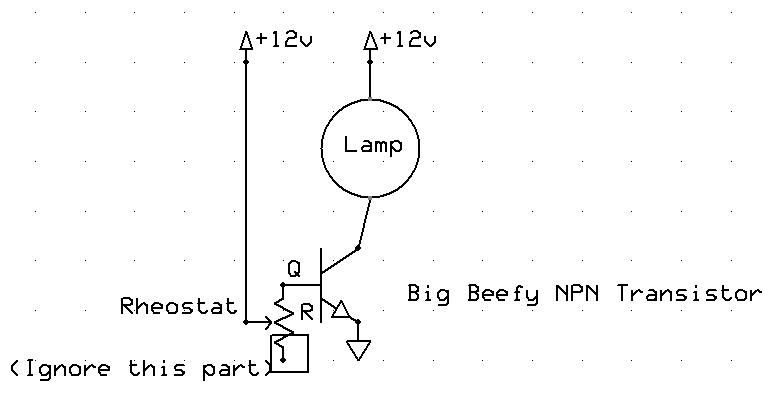

A transistor is DEFINATELY the way to go. so simple to integrate. I would suggest a NPN Power transistor. If you want to continue, lemme know and I will draw you a schemmy of it to help you.
aside from building simple subwoofer crossovers and i only have basic knowlage of transistors etc. any schematic is welcome. all i want as aformentioned is just to have and inline variable manual control of the bulb (varying the value between 6v-12v)
There you go. Just connect the rheostat any way. It has no polarity.

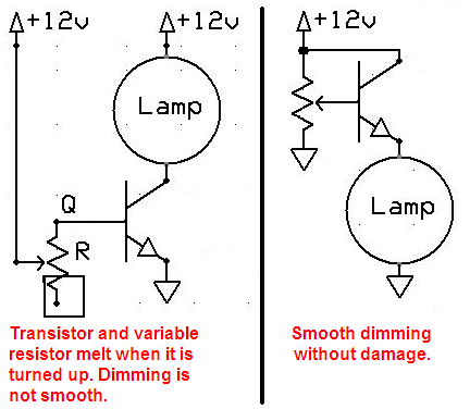

Hi Krumlink,
The transistor will have the full supply across its base-emitter diode when the variable resistor is turned up in your circuit. SMOKE!
Mine is an emitter-follower.
TuscanT said:
o.k
so what exact components/value/type etc would i use to do this
Well a 2N3055 power transistor would work fine and is an easy cheap transistor to find. However like any power transistor, you will have to mount it to a heat sink of sufficient size.
As far as the rheostat I would prefer to see a fixed resistor, to limit the maximum current draw, wired to the pot for decreasing brightness from that set maximum. I'm sure someone here can 'spice' simulate the resistance values for you.
