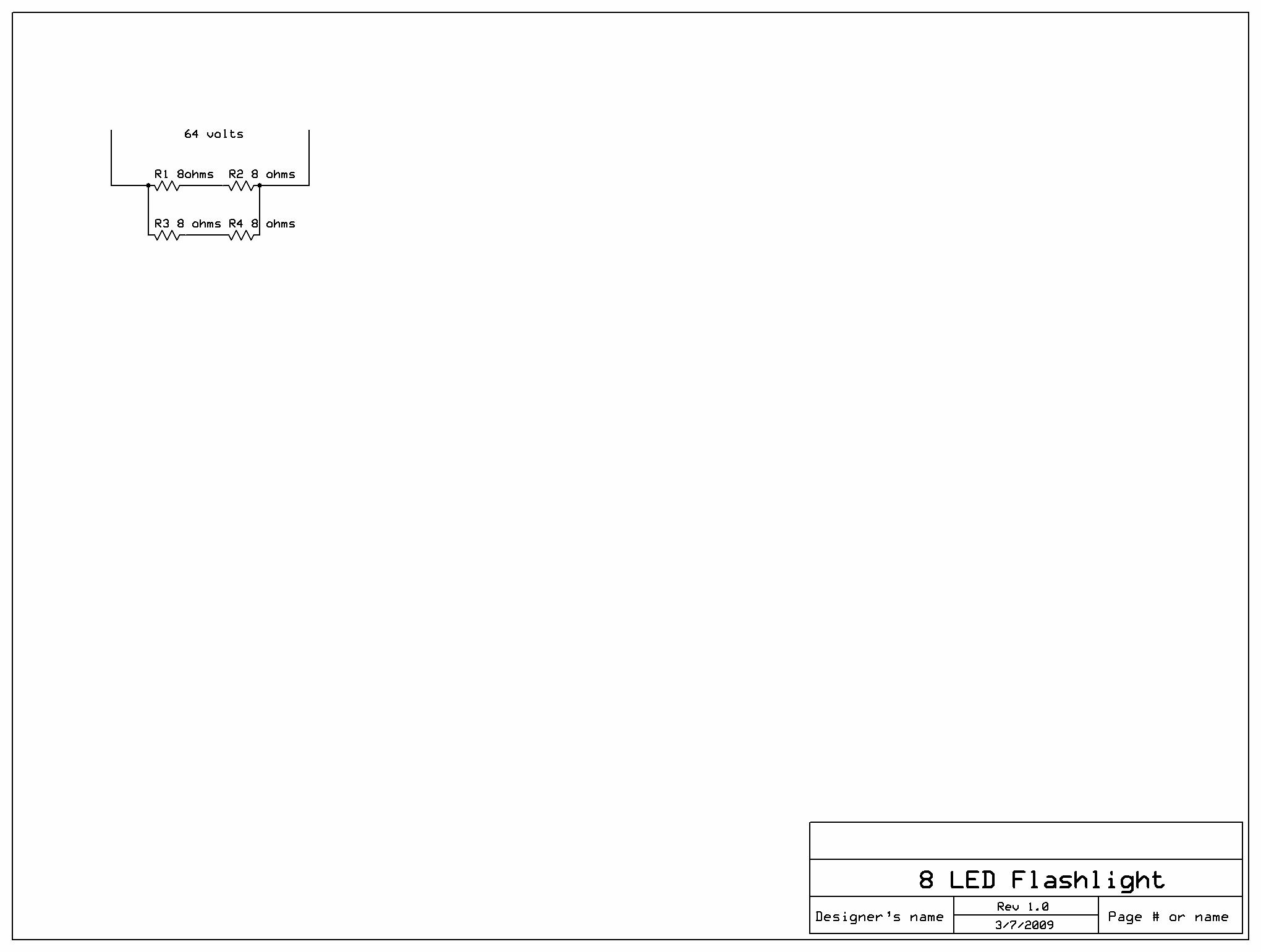

simple series/parallel circuit
64v battery supply
2 -8 ohm resistors in series
2 more 8 ohm series resistors in parallel with other 2.
what is the total amperage of the circuit?
thank you just preparing for a test and making sure my math is correct.
if you dont mind, working out the problem for me?
just the formula of how you got it,
Im not sure I understand your circuit.
schematic ?

a square circut r1 and r2 in series r3 and r4 in series
r1+r2 in parallel with r3+r4
im sorry no schematic
+64v_______________r1=8ohm r3=8ohm
r2=8ohm r4=8ohm
The 4 resistors in a series - parallel array have the same resistance as one of them (8Ω)
Then I = U / R = 64V / 8Ω = 8 A

I think this is the circuit he is talking about. 2 series circuits of 16 ohms each, give a total resistance of 8 ohms. If the resistance of the par circuits are the same, divide it by 2 for 2 parallel circuits. A=e/r: 64/8=8 amps
