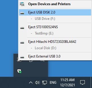

I use a USB 3.0 enclosure case + 2.5" HDD. After copying and reading files, I used the Windows eject function (safely remove hardware). After completing this command, when I tried to disconnect the USB3.0 cable from the PC, my hand hit the enclosure case and it moved a little on the table. Does this shock cause friction between the reading heads and the magnetic platters?

If it flopped over from an edge to it's side with a bang, different story while running.
Laptop drives are extremely shock resistant.
eg. From the specifications of the Seagate one -
Shock, Operating: 2 ms (Gs)
400
Shock, Non-operating: 1ms (Gs)
1,000
400G (400 x earth's gravity) is a seriously massive shock! A minor nudge is totally irrelevant.
I don't know how to measure the force for the 2.5" HDD heads to hit the platters. In my case, the hit was fast, but it moved on the table. First, Windows eject function (safely remove hardware) the USB case + 2.5" HDD in the Windows case. Then I pulled the USB cable connector. It came out quickly and my hand hit the case.
Hitting it with your hand would not be a major "G" force. Your hand is, technically, soft, not a hard surface that is immovable like a floor or brick wall. Some laptop drives will even survive a laptop drop to the floor (though I would never test that theory)
The slight movement of your enclosure case on the table is unlikely to cause friction between the heads and platters of your HDDs. Modern hard drives are designed with mechanisms to safely park the heads away from the platters when powered down or safely ejected. Since you used the Windows eject function, the heads were likely parked, minimizing risk.
If the drive had already shut down, then the 1000G rating applies.
If your hand was in contact with it for just 1/100th of a second with that much force, the drive would be moving afterwards at almost 100 metres per second (over 200 miles an hour).
(And your hand would have been shattered).
Don't worry abut trivial stuff like this!
