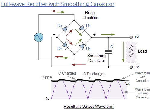

Thanks, do you know a reliable way to convert those 6vAC into dc? Maybe with a FULL bridge rectifier.

Yes, a bridge rectifier and smoothing capacitor. The DC output will be roughly 1.4 * the AC input voltage, less the drop in the bridge rec.
That is typically 1.2 - 1.4V at light load as there are two diodes in series feeding the output, with either polarity input.
Without a capacitor, the average voltage will be near the AC voltage (less the diode drops), but it's pulsing twice each AC cycle rather that a constant or near-constant voltage.
