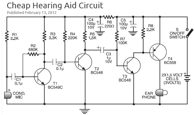

I could not complete the analysis of this circuit.
This is what I managed to do:
IB1 = (VCC - VBE1)/R3 = (3 - 0.7)/100K = 23uA
If β = 100, then IC1 = 2.3mA
VCE1 = VCC – IC1 * R1 = 3 – (2.3m* 2.2K) = - 2.06 V (Error)
The Voltage between points A & B (VAB) = 0.7 volt
So, IC1 = VAB/ R1 = 0.7/2.2K = 0.318 mA
Then, VCE1 = 3-0.7 =2.3 V
I stoppedhere. I wish I couldcalculate IC2 and VCE2 to complete the picture.

The horribly biased first transistor is supposed to have an impossible to find and temperature-sensitive hFE of 100 with a base current of 23uA. Then its collector current is 2.3mA. Since its collector load is a 2.2k resistor parallel with the base-emitter of a PNP transistor then the 2.2k resistor has a current of 0.7v/2.2k= 0.32mA then the base current of the PNP transistor is 2.3mA - 0.32mA= 1.98mA. The PNP transistor might also have an hFE of 100 then its collector current is trying to be 198mA. The collector load on the PNP transistor is 64 ohms so its collector is trying to pull up to 198ma x 64 ohms= 12.7V which is impossible with the 5V supply so the PNP transistor is saturated.

It is just an analysis of a non-inverting High-side switch.
Zin = 100K input impedance
Zload =64Ω load
Vin = Vcc=3V
The load could be a high power relay coil or some other active load.
Each resistor is calculated carefully based on assumptions for the current gain hFE when in linear mode for the 1st stage and when saturated in the second stage as a switch. Unfortunately some interpolation for hFE vs Vce needs to be done from the data sheets, so I'll explain this later.

The circuit is not a switch. It is a horrible Hearing Aid Circuit: https://circuitdiagram.net/?s=cheap+hearing+aid
I simulated it and it distorts very badly. The output begins muted then gets louder and louder while the distortion becomes unbearable.

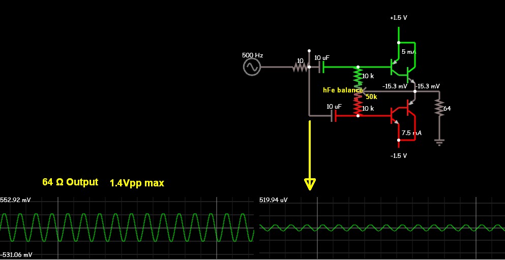

This may be better for you, and still cheap.
Voltage Gain = 1000= 60dB with 64 Ohm load. Zin =32
Pot added to balance hFE between NPN and PNP,
hfe >300 suggested
Design chosen for max voltage gain but no impedance gain.
Previous stage must be complementary emitter follower. then it can be DC coupled instead of AC coupled.
Batteries are split to load. +/-1.5
If you really want to re-invent the wheel and find out it squeaks of draws too much current or is too distorted.

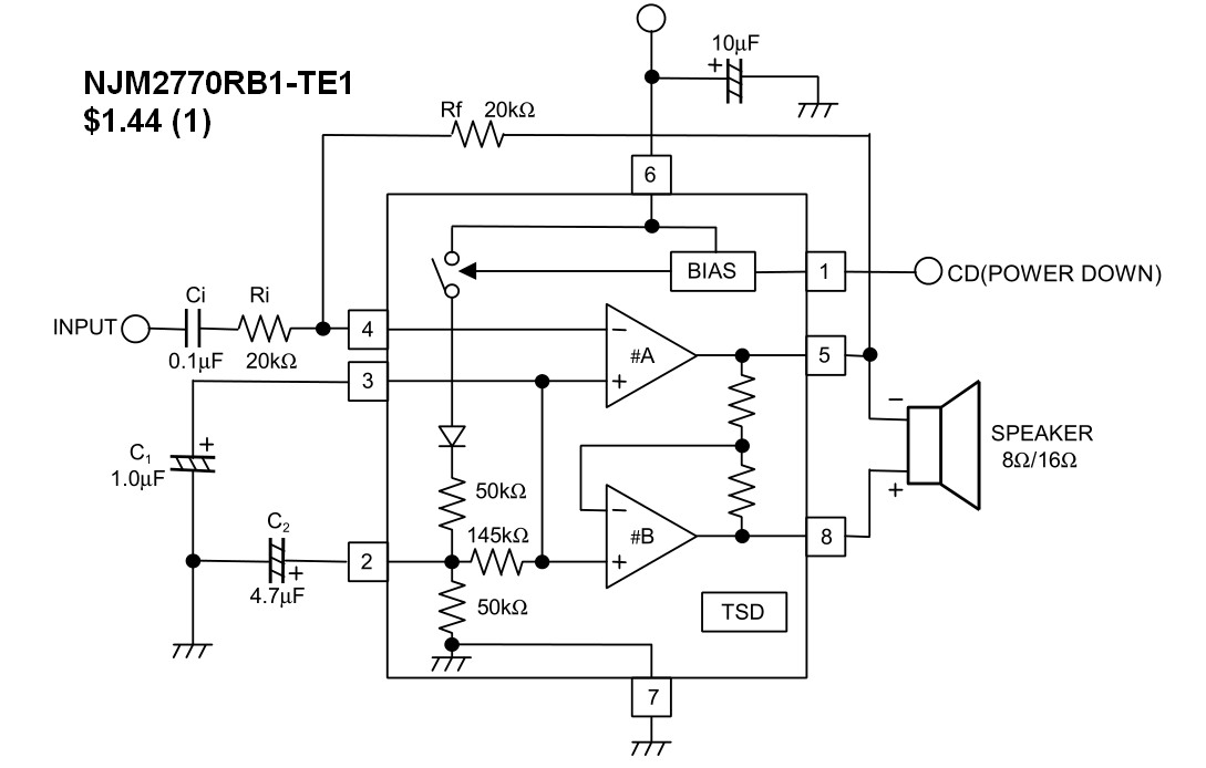

Otherwise, Integrated solutions are far superior. Gain controlled by fixed R values added with Vcc 2~5V ,PSSR = 50 dB, 0.1nA in power down mode, 85dB gain open loop, Vout=0.95 to 1.25Vpp @3V, 0.1% THD @ 100mW
And only $1 in 100pc
