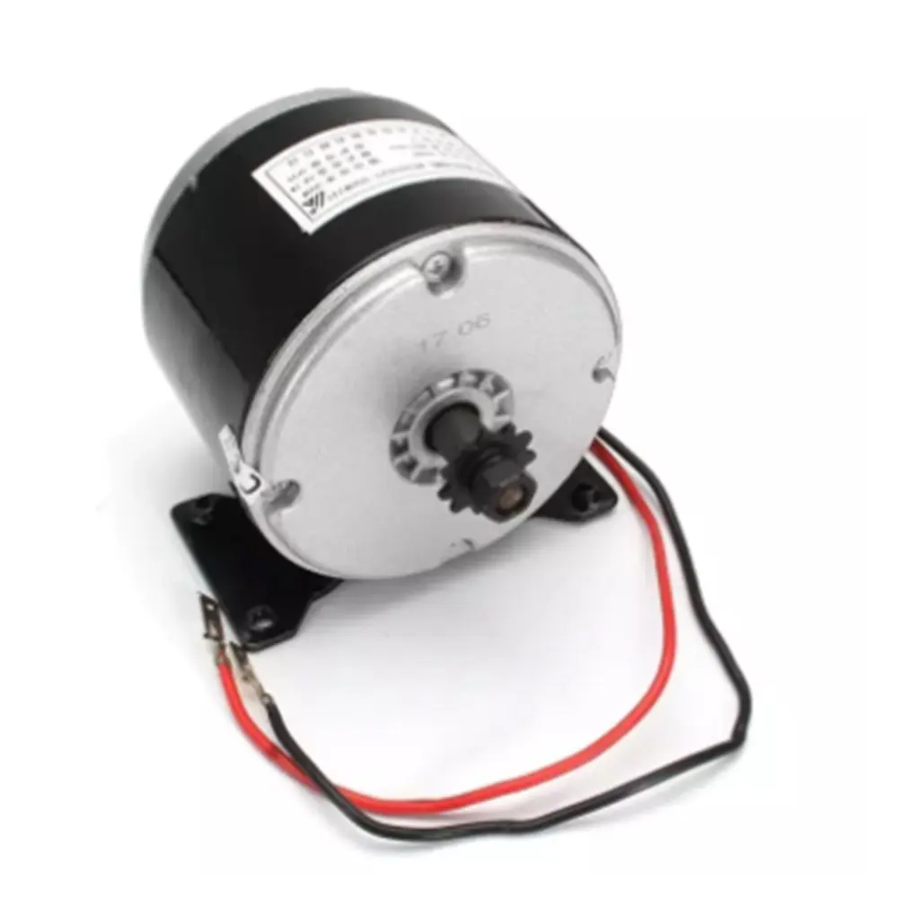

I was thinkign about adding a motor to a bicycle, i these 2 kinds of motor:
and
Here in italy it is mandatory for electric bicycles without insurance that their motor stops working after 25 km/h, and also the motor should not work if the rider is not pushing the pedals with his own strenght. So because of these reasons, i was wondering if those 2 motors would offer resistance when they are off, thereby making it actually harder for me to pedal when they are off?
thanks
There will inevitably be friction which will make pedalling a bit harder. If the motor is acting as a generator and significant current is drawn from it, then pedalling will be a lot harder.

Do you know these type of motors? **broken link removed** different insertions have different specs, i don't know which are real , but the 895 at 24v should provide like 9 kgF/cm of torque, which i believe should be enough? Also there is the option for either 3000 - 6000rpm or 6000rpm-12000rpm. Would that make a difference?
But if there is a switch right at the motor to break the circuit to the battery or speed control, the resistance to pedaling would be a very minor thing. A complete ciruit is needed to make the BEMF as a generator.
No, but it looks as though they would need gearing down a lot for assisting pedalling.

All motors will have friction and cogging torque.
The first is related to mechanical issues, mostly friction in the bearings.
The second is the normal attraction of the poles and magnets, as they rotate past each other.

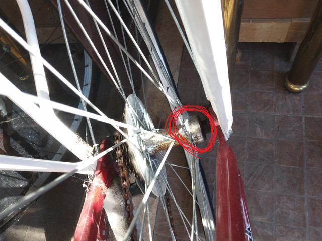

I understand it's quite a bit offtopic but, do you think that if i attach somehow a freewheel(which has a latching mechanism inside) to the other side of the hub of the bike: (i marked in red)
and then connect that to a chain and the chain to the motor it will work?
This because i'm on a budget, replacing the whole wheel with a new double sided hub and can be expensive

That "latching mechanism" inside the freewheel is called a "one way bearing or a sprag clutch" To add one the the other side of the hub you would need to find one that locked up in the correct direction.
Does your pedal set have two sprockets? If you removed the front derailleur cable and locked it so it stayed on only one sprocket, that would then allow you to add a chain and sprocket to the motor. But you would need to lock out the front derailleur if doing this.
