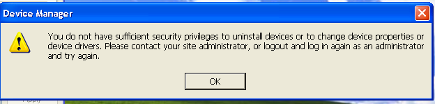

I created a user without admin permissions. I get the attached msg box which does not match what you are seeing although they may amount to the same thing.
If you have an admin (not limited) login you should not be seeing anything like your msg or mine.
Do you have an admin/unlimited type login ?

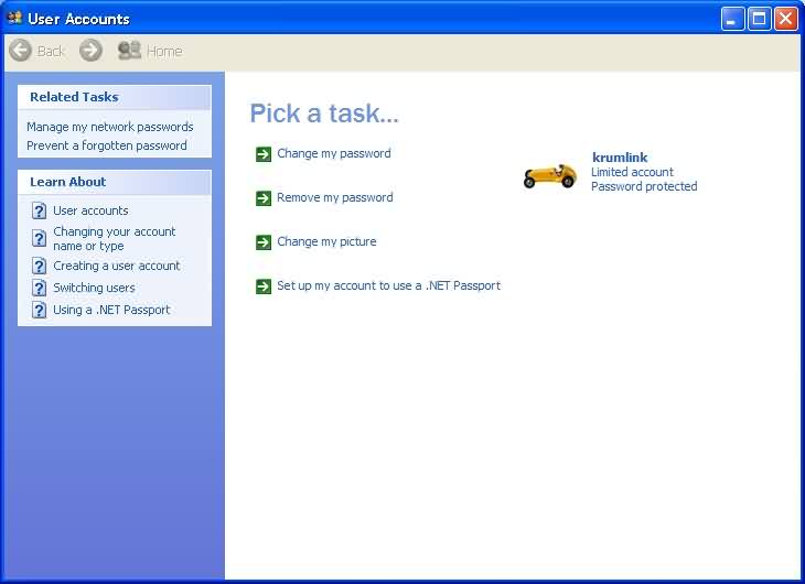

Yeah It says computer administrator.
I dont know what to do. I am so frustrated.
So why isnt it working?
How can I get around this? There seems no other way...
If you were not an admin it would look like the attachment.
This is windows XP problem.
Do you have some sort of anti-virus/spyware software that may be protecting the registry? If you have anything of the sort disconnect form the internet then turn it all (anti-software) off and see if you can make the change. It is windoze so you may have to reboot. Be sure to turn it back on prior hooking back up to the internet.
You could try creating another admin user and see if that one will work. Doubtful but it is the only thing I can think of at this time.
