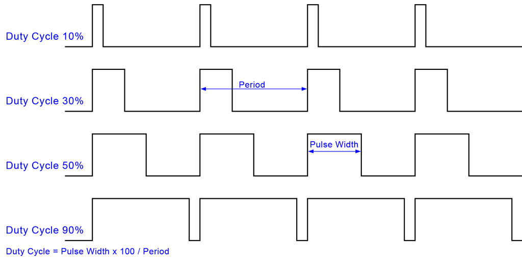

Mike,
I think I was confused.....
This is the actual fade sequence above, isn't it? Of course I will need to tweak it to meet my specific requirements and designations, like pin names, etc...
The longer duration specified for the digital HIGH along with the shorter duration of the digital LOW, determines the brightness, right? Doing away with my analogWrite functions altogether?
And, since the total duration of HIGH and LOW combines to equal 5ms, I am sending a PWM at 200 Hz? Basically, I will be replacing and simplifying my fade sequence altogether and not incorporating your code into my sketch, correct?
The PWM patterns below would represent a dim led at 10% and a bright led at 90%, but each period being 5ms or 200Hz? As my sketch loops, it would add or subtract the delay value to/from 'period' and brighten or dim the leds.... Do I understand this correctly now? Of course, with my led driver being reverse logic, I will need to add time to the HIGH delay duration to reduce the brightness of my leds, right?

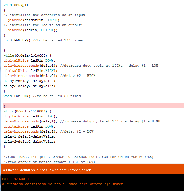

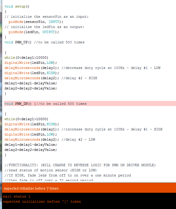

Hi Mike,
I worked late trying to get my sketch to work. I finally changed the 200Hz period to 100Hz and my sketch appears to have the proper frequency now. However, the sketch starts with a very faint LED as expected, but seems to get caught in an endless loop at that point as the faint led remains until I remove power from the breadboard. So now, I have three issues to solve:
  • fix the endless loop so the sketch can continue
  • figure out specifically how and where to add the time delay for each loop to make the PWM_UP sequence last 60 seconds and vice versa
  • Try to figure out why I am now getting the error message shown below as there should be no reason for it to suddenly show up:arghh:
The full sketch is pasted at the bottom of this post.
Error message: why???

I had a rogue '}' in my function that may have been causing the 'function not allow before...' error, but now I am getting this initializer error that I have not been getting during hours of testing this sketch:
Mike,
I finally have the sketch working properly I believe. The only thing I need to add are the delays to the PWM_UP & DN functions to slow things down.
I am currently getting what appears to be approx 7 blinks per second on the led. I am confident the led is fading up, then down very rapidly.
I have the 'for' statements placed in the functions themselves and commented out at this point. I'm not sure if they even go there. I then need to add the delay code(s) to regulate the up and down sequence. Can you help me with that?
Here is the code as it is now:
 VISIBLE_FEEDER_LIGHT_SKETCH_700ma
  The circuit:
 * LED (+) attached to pin 1.
 * motion sensor 'signal' will be attached to pin 2
 * digispark microcontroller
 last edit 8/17/2017
 By John A. Austin
int sensorPin = 2;  //motion sensor out pin connected to digital pin 2 (P2 on digispark)
int ledPin = 1;    // LED driver module's PWM pin is connected to digital pin 1 (P1 on digispark)
int delay1 = 9999; //HIGH pulse
int delay2 = 0; //LOW pulse
const int delayValue = 20;
int i = 1;
int ledLvl=1;
void setup()
// initialize the sensorPin as an input:
  pinMode(sensorPin, INPUT);
// initialize the ledPin as an output:
  pinMode(ledPin, OUTPUT);
void PWM_UP()
//for (int i=0; i <= 180; i++) //need to add .333 sec delay somewhere for a 1 min overall fade up duration
while(0<delay1>10000)
digitalWrite(ledPin,LOW);
delayMicroseconds(delay1); //decrease duty cycle at 100Hz - delay #1 - LOW
digitalWrite(ledPin,HIGH);
delayMicroseconds(delay2); //delay #2 - HIGH
delay1=delay1-delayValue;
delay2=delay2+delayValue;
void PWM_DN()
//for (int i=0; i <= 60; i++) //need to add .333 sec delay somewhere for a 20 sec overall fade down duration
delayMicroseconds(delay1); //increase duty cycle at 100Hz - delay #1 - HIGH
delayMicroseconds(delay2); //delay #2 - LOW
//FUNCTIONALITY: (WILL CHANGE TO REVERSE LOGIC FOR PWM ON DRIVER MODULE)
//read status of motion sensor (HIGH or LOW)
//If HIGH, fade leds from off to on over a one minute period
//Hold leds at 100% brightness for 5 minutes // this delay needs to be added back in
//then fade to off over a 20 second period
//wait 5 seconds and read sensor pin again //this delay needs to be added back in
//IMPORTANT NOTE: reverse logic is required based on LED driver board's PWM pin functionality
//REVERSE LOGIC - CHANGE AFTER TESTING
void loop()
if(digitalRead(sensorPin) == LOW) //if no signal is sent to P2 from motion sensor, then loop:
loop;
else
PWM_UP();
//analogWrite(ledPin, 255); //set leds at full brightness
//delay(300000); //hold at full brightness for 5 minutes
PWM_DN();
//delay(5000);
You need braces after while statement.
I don't know if the compiler accepts the while statement as it is now.
Probably the statements in pwm_up and pwm_dn are executed only once
Should be something like this:
void PWM_UP()
while( delay1 > 0 && delay1< 10000)
Same for PWM_DN()
I rearranged my sketch somewhat to make the PWM_UP/DN functions 'local', replacing my original analogWrite statements. I have a place holder at mid point for the 'PWM' to control the fading time(s) somehow????. This is as far as I can get:
You had stated
The index variable used by the For statement can be the PWM duty cycle argument directly.
,but isn't the 'duty cycle' a specific analog value from the digispark at a 500Hz frequency?? This is the main reason I am confused. In my mind, I have the two functions that adjust the pulse widths of the low/high in a fade up or fade down direction at 100Hz. So, I need to somehow have those functions loop at specific pulse width combinations (brightness levels) for 1/3 seconds before adjusting the pulse width to the next level, either brighter or dimmer.
All of this issue started because I was trying to control 3 high power leds requiring a current of 700ma and was frying my 2n3904 transistors. And mainly, the fact that my led driver PWM function only works at approx 100Hz and the digispark sends a pwm signal at 500Hz. Usually I can figure out a problem in a reasonable amount of time, but this is beating me.... At this point, I cannot logically envision the flow or function of your recommendations, and I have spent many, many hours trying. I do understand the PWM functions and the adjustments to the frequency in Hz. That is no big deal. But getting it to loop and hold at a specific graduation of pulse width has me stumped.
