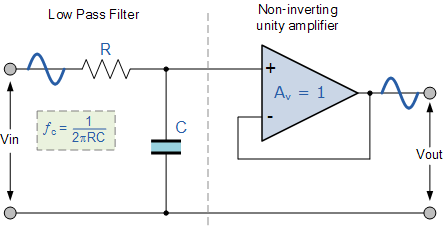

hello guys... my problem is as follows: my car alternator, produces 12v DC, but ALSO produces a low frequency (100 - 1000)hz AC... i have a line, that has up to 20A-30A on it, which i want to filter... completely block all AC..
So i was thinking to build an active low pass filter with a buffer op amp , as follows:
so, the normal line would go to the non- inverting input , and i suppose i would get my filter 12v from the outpout??
my question is this:: If the Vin of the Op-amp (not shown above) comes from the same sources, as the signal in the non-inverting input, so it also has the alternator noise, will the above work?? or should i do something else??

You could always add a small amount of passive filtering to the op amp power source.
You do not have an active lowpass filter. Instead you have a simple passive lowpass filter that has a low output current. Since the RC filter is so simple then if it filters out 50Hz it will take a long time to charge. The formula in your circuit reduces the frequency only a small amount (-3dB).
Most opamps have a maximum output voltage that is 1V to 3V less than their minimum power supply voltage except a "rail-to-rail" opamp that has a very low current load. Your 12V has 50Hz to 100Hz ripple that causes the voltage to go up and down. Even if you used a rail-to-rail opamp then its output will drop each time the power supply voltage drops.

audioguru.. the outpout will be used to power my carpc, (and i hope that enother one like that, my AMP) , so it has to be at least 20A....
i dont understand what you sed... since the op amp is wired as buffer, wont the output be, exactly the same voltage as the non inverting input?? (so with a low pass filter , in the input, you give a pure DC , and in the output you have a pure DC...)
that is my theory, but that is why i ask, becouse i dont have much Xp on Opamps...

That filter does not stand a snowflake in hells chance of working.
You are filtering a signal (the supply to your equipment) as the input to an amplifier, and then using the output of the amplifier to power your equipment.
The power for the amplifier is coming from the same source as the power you are amplifying.
At this point my head hurts, can you not see the absurdity of what you are trying to do?

JimB. i expected the filter would not work, that is why i posted , to begin with..
From your filter that will not filter, you want an output current of 20A. But the maximum output current from an opamp is 0.05A if you are lucky and then its output voltage loss is 4V.
