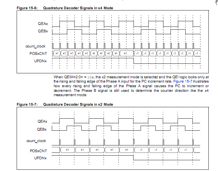

I have a question regarding the QEI module. I'm just learning to use it. I'm using PIC18f2431 and I've just finished reading it's datasheet section about this module.
I got lost here:
Here is what I understood from that section I snapshoted. Please correct me if I'm wrong. I guess I'm.
Fpos = position count rate. This can be proportional to 2 or 4 depending if I configure the QEI to work in "2x Update mode" or "4x Update mode". But what exactly is it. My goal is to get the RPM from this formula and display it on an LCD. What do I need to put in my formula for Fpos? Is it the time difference it takes for the QEI to make an increment/decrement in the POSCNT register?
D = datasheet says number of incremental lines in incremental encoder. I'm not sure what this means. Does it mean that if I have an incremental encoder with 10 divisions my D in that formula will be 2 to the power of 10 = 1024?
Also. Doesn't the frequency at which my ucontroller is working affect that formula at all?

Ref the 16 bit POScnt , this is an Up/Dwn counter which counts the QEA & QEB pulse edges.
When *2 POScnt uses the leading rising edge and falling edge of the QEA pulse to count and *4 POScnt uses the leading and falling edges of both QEA and QEB the pulses to count.
You load from the program the MAXcnt register, this will be used to compare the POSCnt and MAXcnt and raise an Event flag at Zero and when POS=MAX.
OK.?

I wrote a piece of code in which I'm doing the following:
- I assigned value of MAXNT to 240(that is the number of pulses per revolution for my encoder - I'm simulating it in proteus)
- I configured the QEI module in x4 mode and every time POSCNT reaches MAXCNT an interrupt is generated and I'm incrementing the value of a counter(which is the number of rotations)
- I configured TMR0 to give an overflow at every second. In this ISR I'm reading the value of counter in a variable speed(and so I get RPS) and then clear the counter to get a new value.
- The priority for QEI module is low and priority for TMR0 is high.
I cannot get the Timer0 to interrupt at 1 second. I have calculated everything like this.
