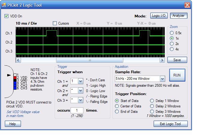

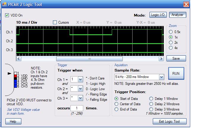

I'm using TMR0 to make PWM. I read the ADC then put a value in a folder. I then turn the output bits on with every interrupt then check throughout the program to see if the timer has exceeded the values from the adc. If I add the timer and the value from the adc together and they trip the flag then I turn them off. The problem I'm having is that the PWM only works for about half of the pot. I have 5k pots on both sides of the 10k to fine tune and I also get good adc resolution using other programs with this same circuit. So I believe the problem to be in my program. I have included the program and a few webshots of what the pickit analyzer is seeing on the output pins. I get what I'm seeing, but I have no idea how my program is doing that. It's like the ADC is affected by the TMR0. Any ideas?

Gayan, you remember that I was making an IR airplane? My old receiver was very glitchy. It was always pulsing the motor because it took too long to read the incoming IR signal in between running the PWM for the motor. Now all it does is read the R signal and the interrupt takes care of the PWM. I have it hooked up straight to the leds which will eventually be replaced by a motor and an actuator. I already have a good IR system made now I have to put the IR system with this new PWM code. Soon I'll make this mess presentable and show pics, schematics, and program codes complete and polished.
Now I have to figure out how to scale the pwm faster. Right now I'm at 15 times per second. I want over 20. That seems to be one consensus on DC brushed motor control.
That is what I'm having a problem with right now. Is it possible to make the TMR0 PWM timer interrupt more often than every 255? For example start the TMR0 at 100 instead of 0 by writing to the TMR0 at the end of the interrupt? If that works the problem will be to get the adc value scaled to something smaller. I'm sure there is a way to do it. I've heard that if you RRF any folder it divides it by two. Is that true?
If, at the end of your ISR, you load d'156' into Timer0 then it will interrupt every 100 counts. You will have to subtract 156 from the value when you read it from Timer0 so that your value will go from 0 to 99.

Why do you think you need more timer interrupts ?
If it is because you can see it blinking? If so is it blinking very fast but steady or sort of random or in some pattern ?

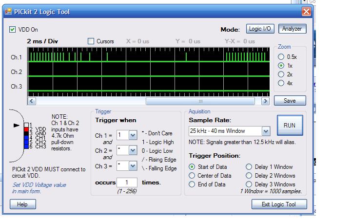

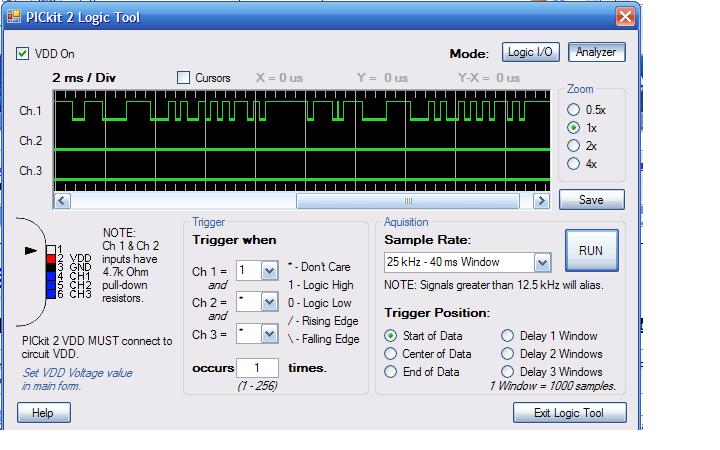

I put it on the pickit analyzer and it is very consistant. It blinks almost exactly 15.6 times per second (as far as I can tell). Here are a few pictures of the analyzer. About that RRF, is that true? It would cut a lot of code out.
The reason I think it needs more interrupts is that on the internet they say in general that 20hz is good for small DC brushed motors.
I think Jeremy's target is to dim the LED & not to blink.
Jeremy is concentrating only with Timer frequency & not the PWM frequency.You need to concentrate on PWM frequency with the duty cycle to dim the LED.
How many steps you are going to use is it 255?
I changed the TMR0 value and it couldn't be smoother. I have leds without flicker and they are completely free of interference and fade independent of each other. Now on to the IR receiver. All I need is to get my next batch of chips!!

If you need it to go faster still then you can double the speed by assigning the prescaler to the WDT. To do this change 0xd8 to 0xd0 where you setup the option register.
Edit, ignore the above, I now see you already have the prescaler assigned to the WDT. Another way to speed it up is to put a larger value in TMR0, something like 200 should do.
By couldn't be smoother I mean that, it's so smooth that you'd have to be pic to understand if it were smoother. I'm really happy with the result. You guys really gave me a big jump forward with my project. Hopefully I can put this together soon and fly a little plane in my house. Thanks a million
