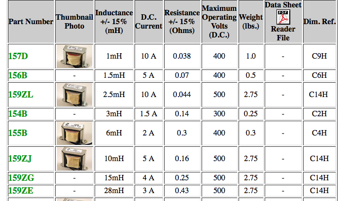

It could be that the small motor has much less inductance. When a motor is run with PWM, the frequency is usually high enough that the current doesn't change much during one PWM cycle. That is messed up if the inductance is small and the current changes quickly. The peak current could be being limited by the resistors not the inductance of the motor.
That makes sense. To test that I could put an inductor in line. What are you thoughts on the Hammond 159ZE at the bottom. The motor is rated at 2.3 amps.

I have a very large 20 amp, 20 MH choke from one of my machine tools. I tried using it and it made no difference, resistors got just as hot.
From the KB manual, the operating frequency is greater than 16 KHz.
