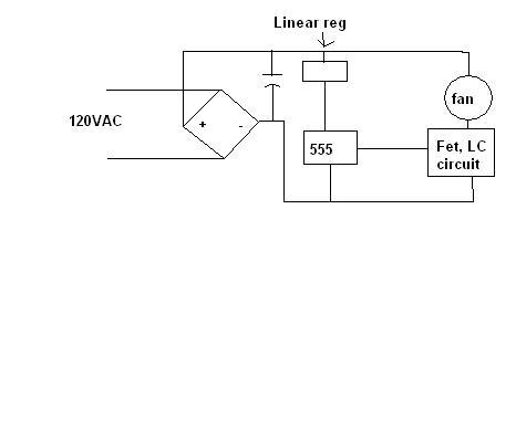

Now I'm confused...
I'll draw something quick in paint to illustrate my original idea... Apologies for crudeness and lack of time.
technogeek said:
Now I'm confused...
That would probably kill the fan as the peak voltage would still be greater than 16V or whatever the drive electronics are rated to.
