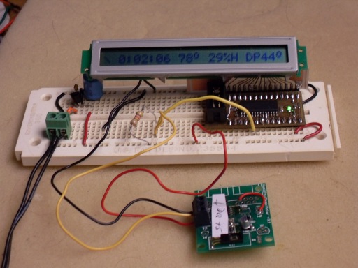

For an inexpensive ($2) LCD 1x24 char display look at thread

For an inexpensive ($2) LCD 1x24 char display look at thread ...
Looks good even with the 0.05" pitch, but the link that was selling the LCD's is gone;
Picture of the display:
Maybe they run out.
