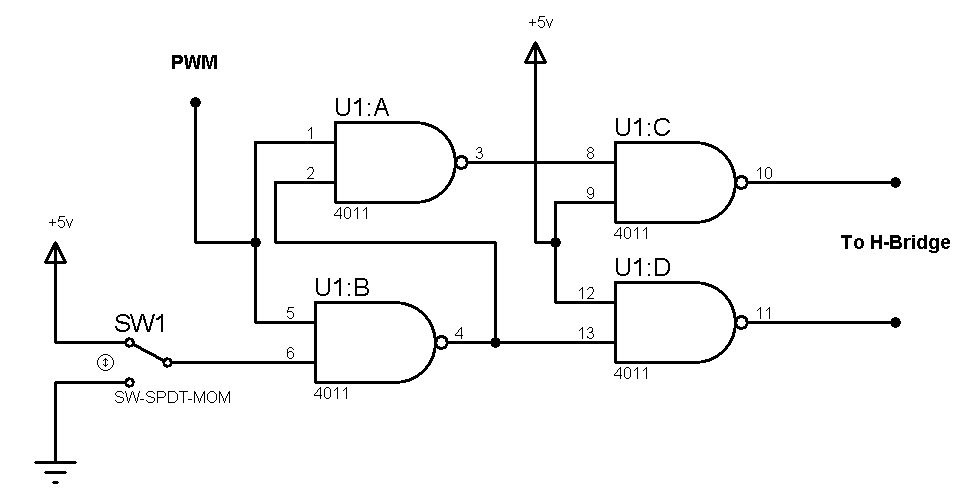

now i am trying to feed the circuit with a PWM
as i am using PIC16F628A , which have 1 pwm channle and can only be outputed to one exact pin.
so i thought of 2 things
1. to take the pwm output pin and feed it to another pin, then redirect the signal to other pin , but i am afriad something can go wrong in timing, beside i will tie up the pic in that job and i will lose the benfit of build in PWM.
2. to put a nand gate IC (4011) to do the job (attached picture), so i gave it a try .
the motor runs very strangly and it is obvios that i have 2 states , FWD and RWD, so i have to power the ic from another pic pin.
anyway i need to hear your ideas and thougts about the second solution or anyother solution that i maybe missing here.
PS ( i cant use a dedicated PWM ic)
thanks a lot

very good!
I inspected your schematic carefully, and it is very fine, actually this is how most of people do to feed the generated pwm to a multitude of devices..
Another approach - while a litle more complicated - is to make a similar pwm distributer, but with an independent output for each transistor of the H bridge, this will allow you also to break the motor (depending on the application..)
In case you don't know, giving the same voltage to the 2 wires of a DC motor will have a breaking effect.

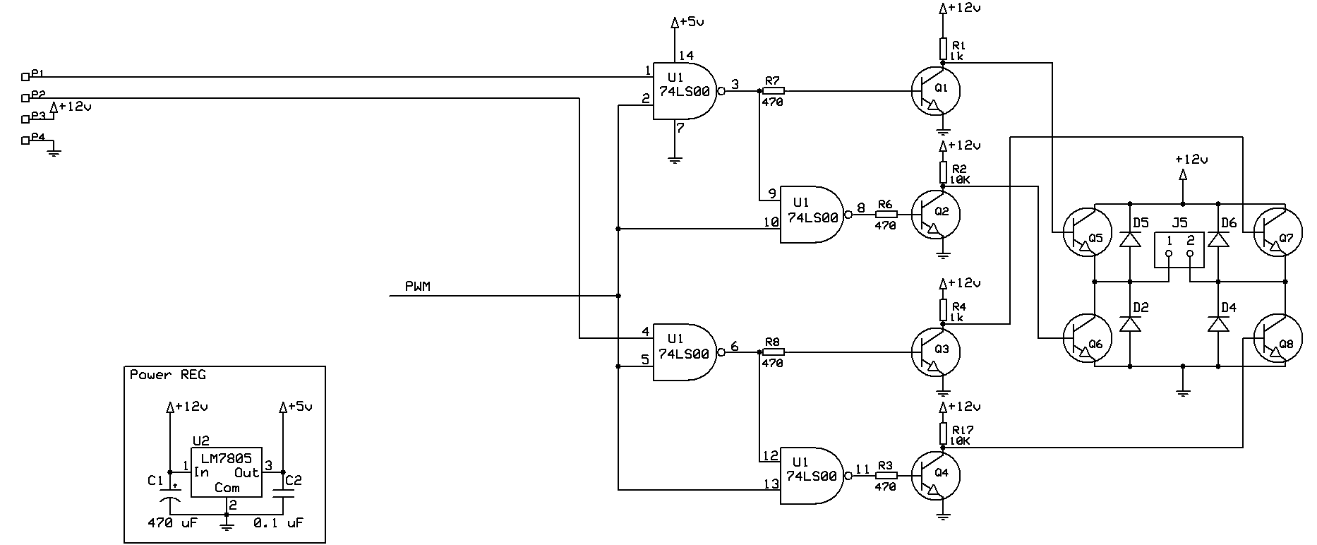

so here a schematic i actually used in one of my university project to control DC motors,
on the schematic, the control is done by the pins P1 and P2:
Giving 00 as input mean the motor is freewheeling
Giving 10 as input mean turn right
Giving 01 as input mean turn left
Giving 11 as input mean break
never mind the additional transistors, those where because i was driving 15A transistors, that required 100mA base current that the nand gates could not deliver....
