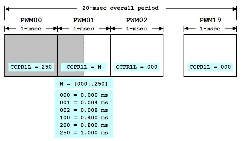

I'm trying to understand the innerworkings of generating a pwm signal from a pic18f4550.
Here are the specs fo the pic/board:
Internal clock of the pic18f4550 = 48MHz
External clock (crystal) = 20MHz
I need the pwm period to be 20ms and the duty cycle of the servo to be 1-2ms to turn the servo left or right. Therefore the following calculation should give me the period.
20,000,000/(255+1)x16x4 = 1220.70Hz for the pwm frequency. This doesnt seem correct though. Can someone help me determine what my Timer2 prescale, Timer2 postscale, and PR2 variables should be?
Thanks!

Hi Phil,
A 20-msec PWM period is 50-Hz. Much too slow for the PWM module.
I've not done anything with the '2550 and '4550 samples on the Lab' bench here. Can you tell me what the core instruction speed is? Surely it's not 48-MHz, is it?
Regards, Mike
Hi again Phil,
I've not played with Servos before but I suspect setting up the PWM peripheral could provide good resolution at reduced processor overhead compared to a pure software solution. Unfortunately, as I mentioned before, I'm not sure you can setup the CCP module for a 20-msec PWM period. And if you could, you wouldn't have very fine control of that pulse width. Perhaps only 50 or so 20-usec steps between 1.0-msecs and 2.0-msecs using a 10-bit value for CCPR1L.
I wonder if something like this might work (drawing below)?
Break up the 20-msec overall Servo period into twenty periods by setting up the TMR2/CCP module for a 1-msec PWM period (4-usec TMR2 'ticks' and PR2=250). Enable TMR2 interrupts and preload the CCPR1L duty cycle register each interrupt with a value of 250 for period PWM00 (100% duty cycle), with a value of N (000..250) for period PWM01 (variable duty cycle), and with a value of 000 for periods PWM02 through PWM19 (000% duty cycle). The end result would be a 1.0-msec to 2.0-msec pulse with 0.004-msec resolution in 250 steps within a 20-msec period. And as you can see in the code example below, using very little processor 'overhead'.
The interrupt software could look something like this example for 12F683 where your main program outside of the ISR would simply stuff the Pulse variable with some value between 000 and 250;

Hey fellows. How do you experts do it?
Regards, Mike

Phil,
Timer 2 uses clocks of Tcyc (Tosc*4) for the clock source. That's approximately 83.3-nsecs for your 48-MHz system clock.
Section 13.1 in the '2550/'4550 Data Sheet shows that two bits in T2CON allow prescaling clocks to Timer 2 by 1:1, 1:4, or 1:16 and four bits in T2CON allow postscaling clocks coming from a Timer 2 / PR2 period match by 1:1 through 1:16 before setting the Timer 2 interrupt flag.
The maximum period we can set up on Timer 2 with your 48-MHz clock is 5.46-msecs (83.3-nsecs * prescale 16 * postscale 16 * PR2 maximum value 256). A wee bit short of the 20-msecs you're lookin' for.
Again, you might want to consider a shorter interrupt and a simple counter mechanism in your interrupt handler code to signal the beginning/end of the 20-msec period. Or, a slower clock?
I wouldn't want to tie up my micro project for 1 to 2-msecs every 20-msecs in a delay routine where I couldn't perform any other processing but if your main code can get by in the remaining 18 to 19-msecs each period, that's fine.
Good luck. Kind regards, Mike

Phil,
The Data Sheet shows that a 48-MHz Fosc from a 20-MHz crystal is possible by setting the PLL prescaler divider to 5 to produce the 4-MHz signal that the 96-MHz PLL requires. Then using a PLL postscaler divider value of 2 on the 96-MHz PLL signal do drive the core at 48-MHz.
So what core frequency are you running exactly? It seems you may not know for sure? And I suspect Nigel may not be quite up-to-date on the oscillator chain in this device.
As for your interrupt code. If it's setup to generate the 1 to 2-msec pulse every fourth interrupt then the interrupt period must be 5-msecs. If you set it up to generate the pulse every other interrupt then the interrupt period would be 10-msecs, as you said.
Mike

Phil,
It seems an 8-MHz Fosc would allow a 20-msec Timer 2 period. Tcyc would be 500-nsecs. Setting Timer 2 prescaler to 1:16 would provide 8-usec 'ticks' to the TMR2 register. Setting PR2=250 would provide 2-msec 'ticks' to the postscaler on each TMR2/PR2 match. Finally, setting the postscaler to 1:10 would provide a 20-msec interrupt.
Those same prescaler, postscaler, and PR2 settings would provide a 10-msec interrupt using a 16-MHz clock or a 5-msec interrupt using a 32-MHz clock.
Food for thought. Regards, Mike
