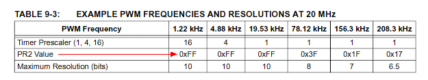

When PR2 is set to 0xFF, it's like it isn't even there.

Re: A Picky Point
It is still there. In fact it gives the longest period on the PIC PWM output at the current clock speed & prescaler.

I did not say PR2 wasn't there I said it's like PR2 wasn't there because there is no essential difference between letting TMR2 roll over to zero by incrementing from 0xFF, and reseting it to zero because it equals 0xFF. If you can only look at the value of TMR2 you can't tell the difference between these two cases.
The difference only becomes obvious when a value other than 0xFF is placed in PR2.

I have read your explanation several times but still I'm lost as what you really meant by "like it wasn't there".
When PR2=0xFF, TMR2 only reset after 256 more increment. This led me to believe "it is there".
With PR2 set to 0xFF consider what happens as TMR2 increments. TMR2 increments from 0xFE to 0xFF. Now TMR2 == PR2 = 0xFF. On the next clock pulse TMR2 is cleared by having eight zeros jamed into TMR2.
Now suppose we take PR2 away from the circuit. Now TMR2 would increment from 0xFE to 0xFF just like in the previous case. On the next clock pulse instrad of clearing TMR2 we let it increment. It goes from 0xFF to 0x00. This is the same result as in the previous case.
TMR2 goes throught the identical set of states regardless of weather we clear it when it reaches 0xFF or we increment it and let it roll over. PR2 can be there or not TMR2 will behave the same way and looking at the value of TMR2 you can't tell what the PIC hardware is doing under the hood when PR2 has the value 0xFF. This statement is true for this value ONLY.
Hi Papabravo,
You are of course, totally correct. I realise my mistake in my previous postings.
I have finally figured out what you meant. Sorry my mind was so fixated on the relationship between value of PR2 and PWM output.
Normally TMR2 counts from 0,1..254,255,0....in counter mode.
When it is used in PWM, TMR2 will count from 0,1,...N,0, where N=value in PR2.
However, when PR2=0xFF, TMR2 will count from 0,1,...254,255,0...as if PR2 isn't there.
I apologize for any upset that you may have felt. I need to be mindful that my English may not be your English. When simple sentences deviate from simple structures, meanings can and do get lost. I'm glad we are now on the same page. You know the hardware. I knew that.
