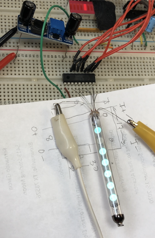

I also used a microcontroller but instead of shift registers I used a MCP23016 I2C bus extender, to light up some IV-25 vacuum fluorescent displays.
Of course, for the latter there is a special high voltage driver, but otherwise you can drive high efficiency LEDs directly.
As a fact you can see in the attached photo I am driving a combination of LEDs and VFDs.
Since the LEDs light up when sinking current but the VFDs light up when sourcing current, their pattern are complementary.
But to your question, you employ the CD4017’s Q7 output to reset the 555’s reset pin.
Since the reset on the 555 is active low, you use a PNP transistor to invert the Q7 signal. A push button in parallel with the transistor will re-start the clock.
There are many ways to skin a cat.
I love the fluorescent display :D - but I presume you've only done it for fun, rather than a practical use?. Particularly as it's easily duplicated with a simple row of LED's :D
A VFD full of characters and words (as used on VCR's, DVD's etc.) is rather more difficult to duplicate, but VFD's obviously suffer from short life spans as well.
Indeed, the soft blue glow of VFDs is very appealing. The photo doesn’t do justice.
I did this project out of curiosity, and because they were really cheap, like $10US for 10 tubes. So I said, why not? And ordered some from an Ukranian vendor.
The idea was to understand them first, then use the I2C addressing capabilities to build large strings of devices.
This, of course, was shortly before the invasion. The seller has now disappeared from Ebay, I ignore what has happened to him.

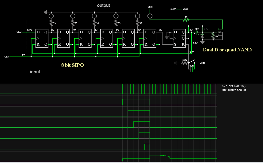

Did you want to specify the step rate and fade period and I & V in each LED? and Vdd, I suggest Vdd= 3.3 to 3.7 (LiPo) using 74ALCxx 25~33 ohm drivers
You can do this 2 IC's with a Lithium cell using 74ALCxx SIPO to drive the LEDs with internal RdsOn of 33 ohms for 15 mA or so. Then make a Relaxation clock using a NAND Schmitt inverter and also make an SR FF instead the D FF using only S&R.
The 6 stages create the State Machine and the last state is controlled b y the RC time constant and protects the input with a Schottky diode.
A uC is cleaner but the best tool is the one you know how to use. I designed this one in < 30 minutes.
