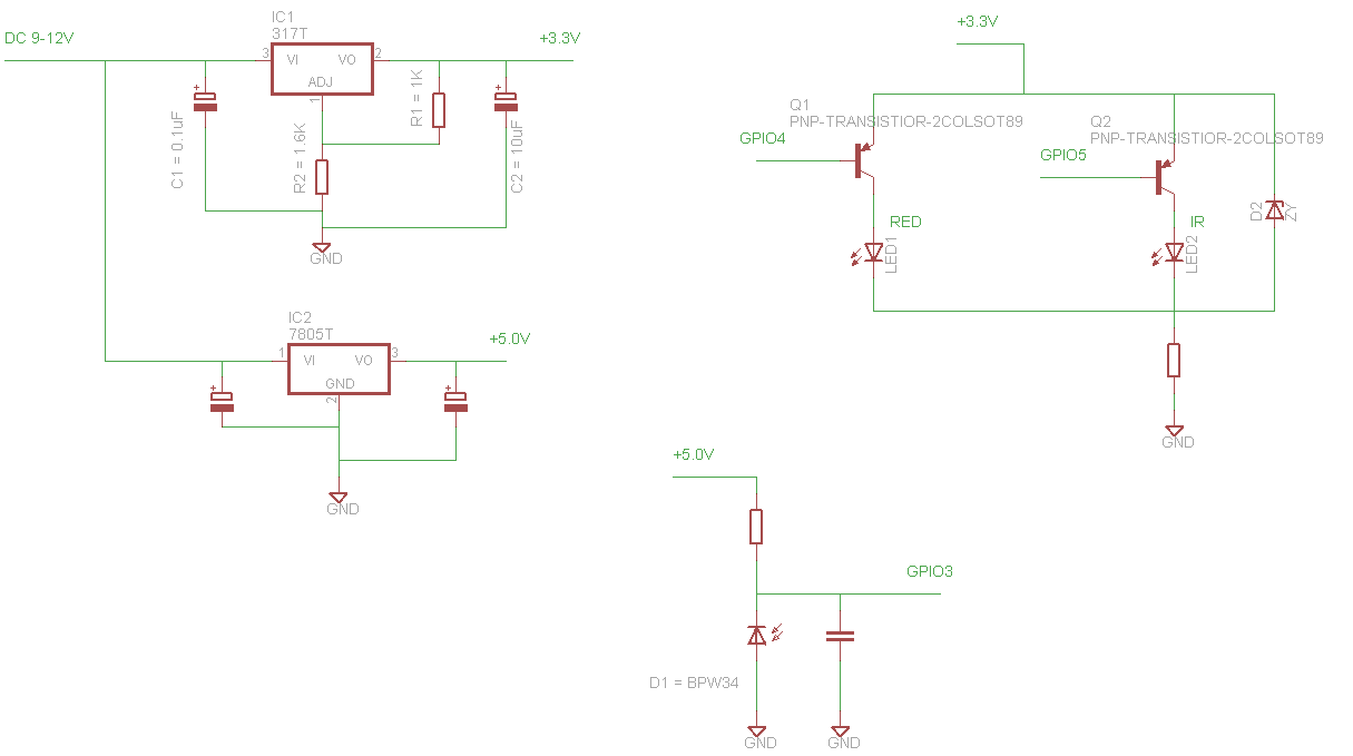

Hi All,
I am trying to make a pulse oximeter finger probe , i have 50% success as i can get a clear heart beat from a BW34 sensor .
The problem is when i turn the IR LED off and keep RED LED on , i dont get any pulsating data ?
I have read many app note , where the circuit drives both LED's at +3.3V , do i have to increase the voltage for RED LED ??? any clues ??
See my circuits attached
Regards

You ought to know that LED brightness is controlled by current and that shorter wavelengths have higher voltage.
usually IR =1.2V and RED=2.1V thus each requires a different Rs to 3.3 to control the current.
Your design incorrectly shared the same R thus with RED there was less voltage drop across Rs meaning less current.
Can you solve it from here?
I use RED 30 deg 10,000 mcd. For this application I think the smallest lens angle is best for maximum intensity.

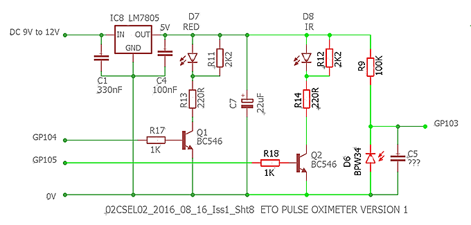

Hi ProFPGA,
Here is a rearrangement of you circuit which is simpler and should provide an improved performance.
spec
Issue 2 of 2016_08_17
NOTES
(1) The value of R13 is notional and defines the red LED on current.
(2) The value of R14 is notional and defines the IR LED on current.
(3) The value of R9 is notional and defines the opto receiver diode speed and voltage gain.
(4) I would imagine that the output from the opto receiver diode would need to be amplified with an opamp.
(5) If the microcontroller operates from a 3.3V supply line, I would imagine that a potential divider will be required between the oximeter and GP103.
(6) The sense of GP104 is now reversed (high turns the red LED on).
(7) The sense of GP105 is now reversed (high turns the IR LED on).
(8) R11 is included to speed the red LED turn-off.
(9) R12 is included to speed the IR LED turn-off.
(10) C1 is ceramic X7R dielectiric, +- 10% or better, through hole (not surface mount), 18V minimum. A higher capacitance can be fitted.
(11) C1 should be mounted as close as possible to the terminals of the voltage regulator.
(12) C4 is ceramic X7R dielectiric, +- 10% or better, through hole (not surface mount), 10V minimum. A higher capacitance can be fitted.
(13) C4 should be mounted as close as possible to the terminals of the voltage regulator.
(14) C7 is aluminum dielectric, +- 20% or better, 10V minimum. A higher capacitance can be fitted.
(15) All resistors are metal film, 5% or better, 250mW minimum (unless otherwise stated).
spec Your RED LED has lower current then the IR with R13=R14
ProFPGA , you just need to compute the current you want and choose separate R's for each LED.
PNP off 3.3V is Ok or 5V, whatever you choose with different R values of course.
IR LED's have a lower Vf and also can support higher currents than the same size RED.
Choose parts for the maximum Luminous Intensity , Iv, for best results.
Pulse currents may exceed average according to specs.
Photodiode R value affects both rise time and voltage gain.
Also unless you can calibrate your Iv value emitting from each LED, you can expect as much as a 3:1 variation in batches , sometimes more. My supplier has single bin 10% tolerance.
Tony, it is the architecture of the circuit that counts at this stage. The values you mention can all be adjusted. None of us know what the characteristics of the system are at the moment because we do not know what the red LED or IR LED are. Current is not the end of the story. The same thing applies to the opto detector. Don't trouble me with details.:)
spec
Update of 2016_08_17: notes have now been added to the schematic in post #3

As for the circuit design , i detected that i burned my IR LED by not putting a series Resistor , now i am testing them both with 220 ohm series resistor and using PN2222A transistor to switch them on and off alternatively from PWM source , the PWM source output is 4.58V peak pulse therefore using CD74HCT02E as a buffer . IF this arrangement still fails to output pulsating data when RED LED is on i will try "Spec" 's ckt .
Fingers crossed :)
spec's circuit is no better for sensitivity.

I noticed that "spec" circuit has only 220 ohm resistance in series , and connected to 5V output of an 7805 , wont that also burn away the RED/IR LED's ???
If you use Spec's circuit, or if you drive the LEDs with low-side NPN transistors such as the 2222a, then you don't need a 3.3V regulator. If you use the circuit in post #1 then you risk frying the micro unless you include series base resistors for both transistors.

This can be made to work on any voltage from 3.3V to say 12V
You compute the voltage drop on the series R for each diode to choose the current needed like 10mA.
so for IR Vf=1.2 and Red Vf=2.1. using Vcc=5V, and allow Vce drop=0.1
Rir= 3 7V/10mA =370 Ω +\- 10%
Rred=2.8V/10mA=280 Ω. +\- 10%
Then I base=~10% of load or (5V-0.7)/1mA = 4k3
basic Ohm's Law

Don't mess about. My circuit will not only protect the LEDs but it is simpler, more reliable, more predictable and more suitable for development and optimization.
