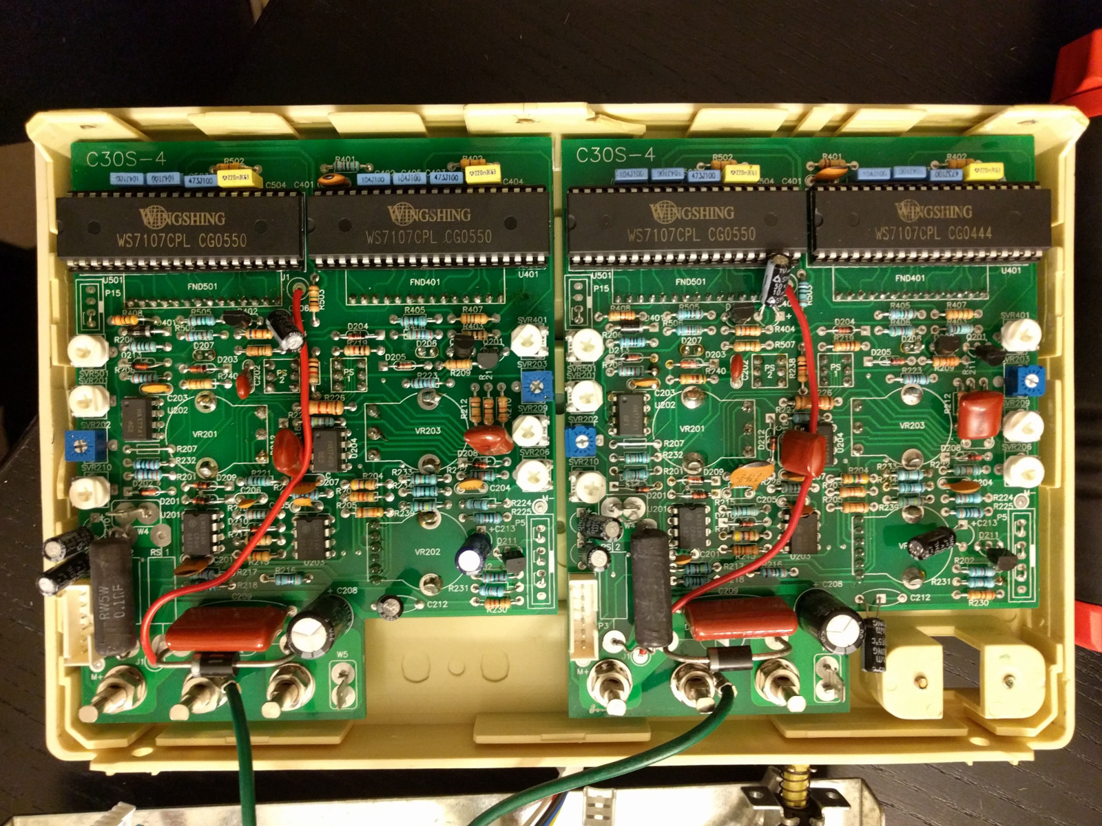

Did anyone find the schematics for the 3015B? The control board is quite a bit different (opamps, trim pots) then the 3003B board. The control board and display board is marked "C30S-4".
One of my supplies only goes to 0.15A and the other goes to the expected 1.5A. Tested with a current sink and it's the actual regulation, not the display.
Picture attached and a high resolution image on Imgur for those interested.
