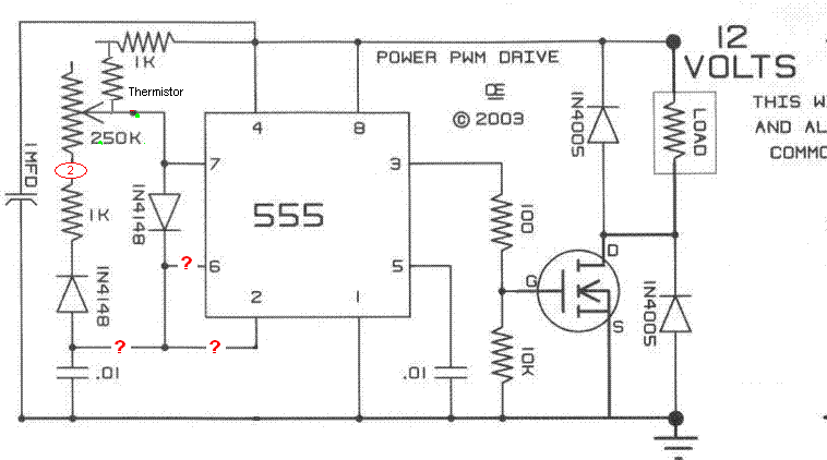

Maybe, but it's going to take a little putzing around. Your thermistor is near the value of the pot: 250k at room temp. The resistance goes DOWN when it heats up, so if you disconnect the leg of the pot that's on the side you turn it to go LOWEST on the pwm, connect the thermistor between the 1k resistor and the wiper on the pot, so it works like that side of the pot... See what I'm getting at? Instead of lowering the resistance with the pot, you now lower it with the thermistor. PWM goes down, heater cools off, thermistor cools off, PWM goes back up, etc.
So I tried this and it did the opposite.... When I disconnected one leg of the pot and connected the thermistor between the 1k resistor and the wiper on the pot, upon operation the PWM signal was very weak and as the element slowly heated up, also heating the thermistor, the PWM signal (power) started to increase.
So... either I am wiring something wrong or maybe I need to try a different approach. I even tried putting adding in the thermistor on the opposite side of the POT an had the same result.
I am a newbie to this stuff so the following paragraph may be hard to understand, but I have a thought that maybe someone can confirm true or untrue.
Can I put the thermistor somewhere in the circuit that controls the "reference voltage?" so that, when cool, the resistance on the thermistor is higher, creating a lower reference voltage, and the result is a higher PWM output; until, the thermistor heats up during the initial initial operation, decreasing its resistance, increasing the reference voltage, reducing the PWM, thereby creating a temperature-dependent reference voltage which I hope can give me the control I need. I also would need some type of tuning POT where the thermistor is to adjust my max PWM output right?
Here's a pic of what I've done so far on the circuit.
#'s 1 and 2 are where I tried splicing in the thermistor (During separate test runs)
Are any of the red question marks in the right location for the thermistor to be a factor in changing the "ref voltage"?

You had it when you put it where the red line is (make sure you lift the leg on the pot so it isn't in parallel). The potentiomer has to be set toward the low end of the range, and it will get a little sensitive. You might try a 50K pot to make it easier to adjust. This will give the increasing PWM "on" percentage for a decrease in resistance.
When the pot's set at about 50k, at 25˚C it will be about 80% "on". At 140˚C the thermistor is only 4k, and that's less than a 50% duty cycle for the heater. Reducing the value of the pot increases the duty cycle percentage.
Yes, there is a "Control Voltage" on pin 5 - but in this circuit changing that voltage will just change the frequency, not the duty cycle %.

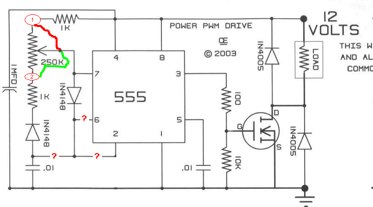

You said lift the leg on the pot so it isn't parallel.
Okay... so reconnect the thermistor loop from the 1K resistor to pin 7 and disconnect the wiper from pin 7
OR
do the same and disconnect the uppermost POT pin?
Like this -
mmmmkay...
still doing the opposite of what it should.
The power goes up as the thermistor heats up not down like I need it.

It's in the right place if you put it where I said to. I took the trouble to build the circuit myself and double-check it on a scope and it behaves just like I said.
Don't know what you're seeing, or why, but if that's really an NTC thermistor (did you measure it?) and you did what I said, it won't be going "the wrong way".
Put a scope on the output of the 555 and look at it.
Alright... Progress...
You were right duffy.
It does work now... however I had to reverse pins 1 and 3 of the pot to get it going in the right direction now...
I think how the kit maker layed the pot out on board is different from the schematic.(pins 1 and 3 reversed)
Maybe that explains why, when I turned the POT Clockwise the power was reduced...(Isn't it usually supposed to be the opposite?) and power increased when it was turned CCW.
Anyways.. thats history... the power is high until the thermistor gets some heat... then I can see the element cooling off...
