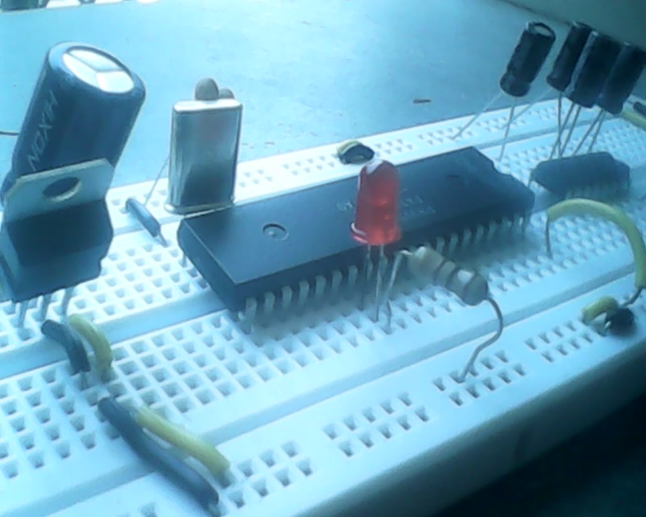

Yikes!
Turn your LED 90 or 180 degrees and place it physically between the processor and the regulator. Think of it as another component. Now you can use a jumper to from the LED to +5 and a jumper from the (-) side of the LED to the port. This assumes the port sinks (connects to ground) current.
Assuming the port SINKS current. I remember 18 mA, but not sure of the source sink spec.
ok and what about other component , Is it correct? this cable will be work ?
"other component" - language problem. The LED is placed on the breadboard where you cannot connect to it properly, so move it physically between the processor and regulator where there is some free breadboard room. Now wire it. It HAS to have a resistor in series with the LED. Once you have that, then connect the resulting "device" (LED+Resistor) to the port and +5.

look max2s232 Ic, look at pin 2 and pin 16, is it correct?
and also look at led connection

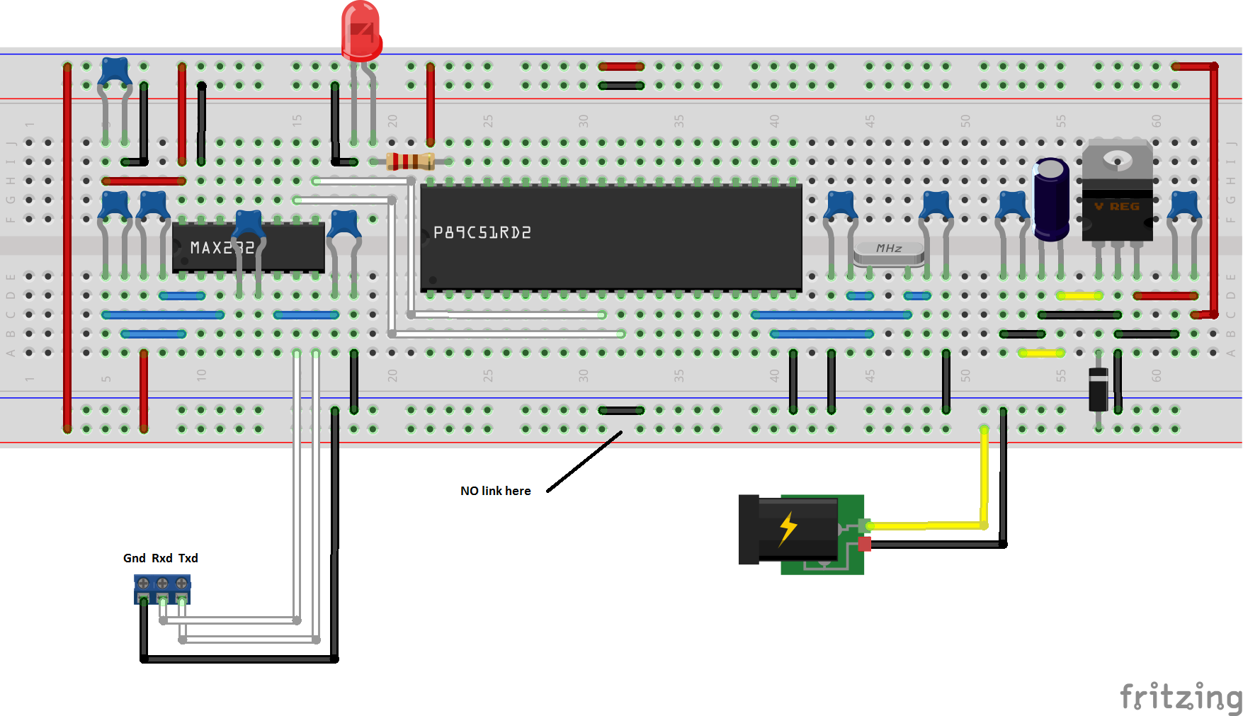

You still don't seem to realize that the two rails at the top and bottom of the breadboard are continuous.
As you have linked the two together, you have your input and output of the voltage regulator on the same rail..
The LED is now connected without the resistor as the resistor is in parallel to the 5v rail, and your diode is the wrong way round.... I have done your circuit in "fritzing" so I will post it a soon as I get to work!! What ever you do... Don't connect up the power to the board.

The LED will not light now as it is in parallel with the 5v as soon as you apply a 0v on that pin it will fry!!!
One last thing..... If you check out the picture.. Look at the power rail connections...

Fritzing will do a layout... Designspark from RS or Eagle lite....
I use Proteus... A bit expensive, but good for me as I use Proteus alot!!!
