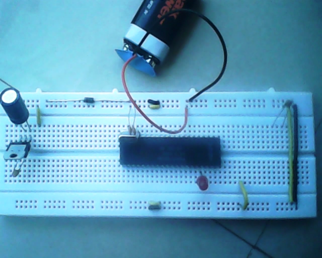

I need help, I am beginner , I want to learn something by doing some work on hardware I bought some electronics lab tools and component
small project - I want to blink Led using microcontroller
microcontroller -p89v51rd2
breadboard
wires black, yellow
battery 9 v dc
Electrolytic Capacitors 1000 μF
diode 1n4007
Ceramic Capacitors 22 ρf
7805 regulator
LED
crystal oscillator

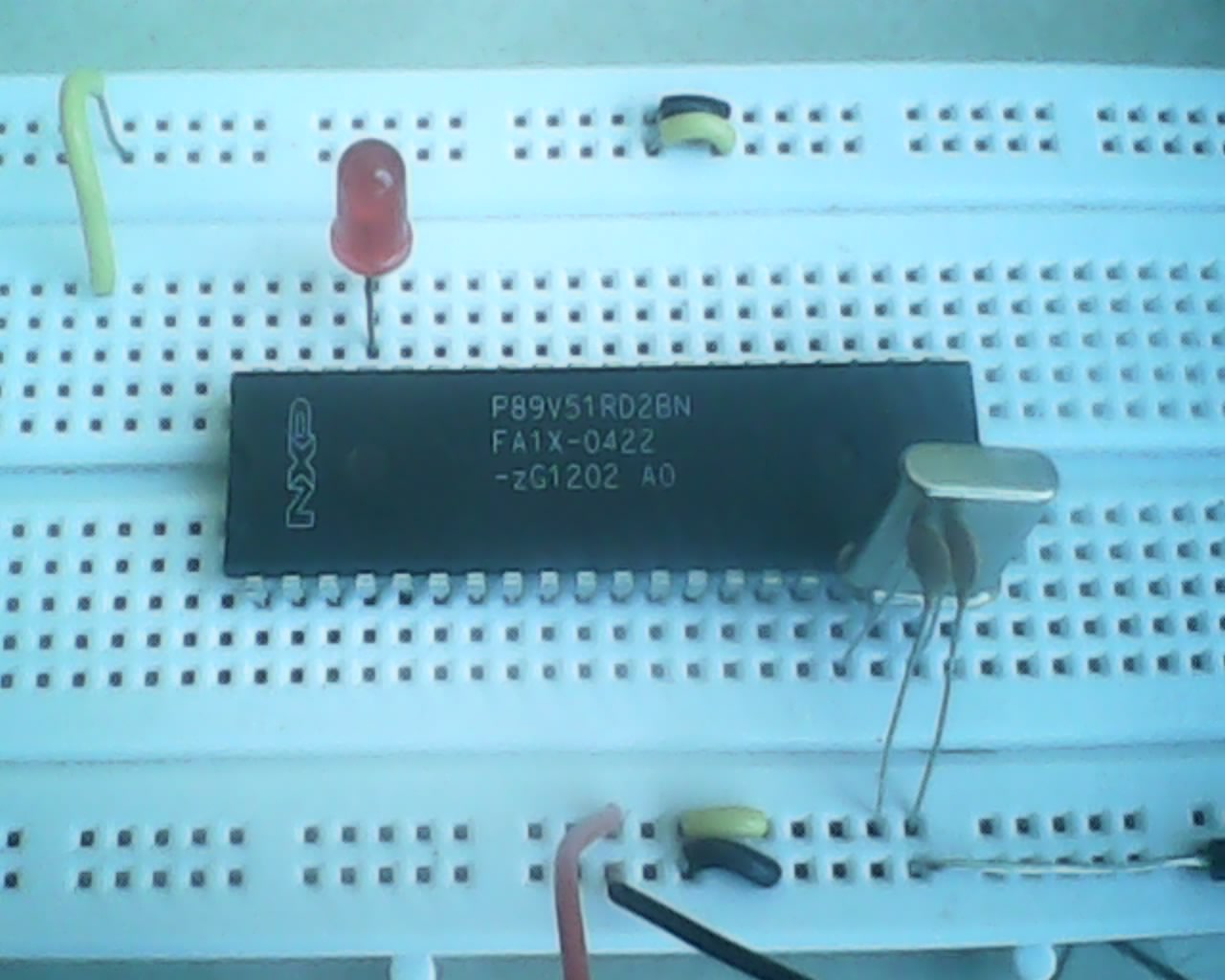

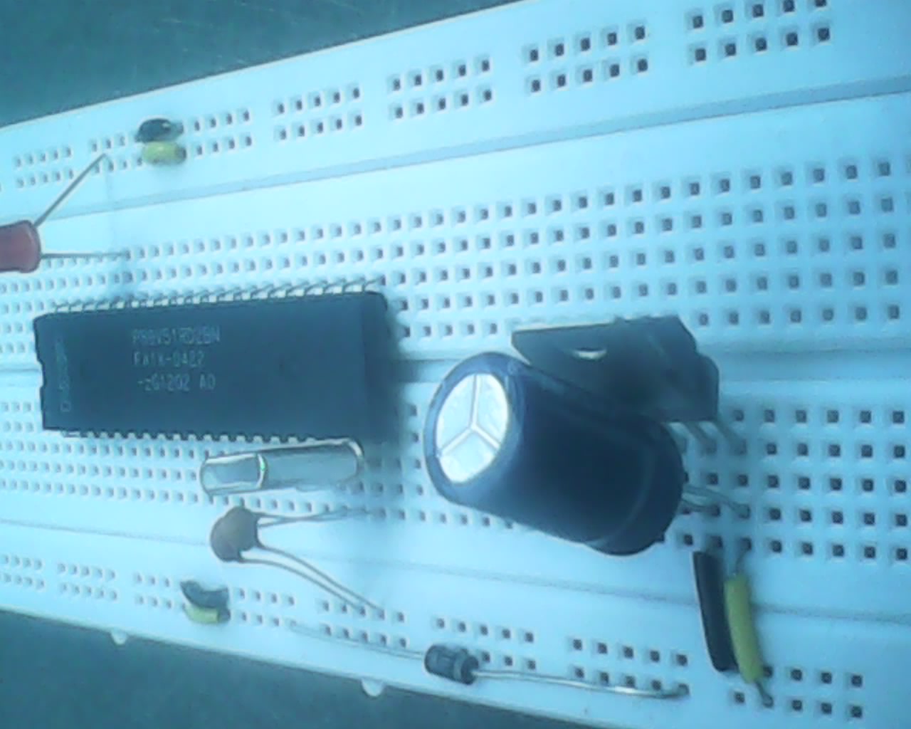

I have made some connection on breadboard, not all but trying to complete I have upload Images please check out me and tell me where i am wrong. remember this is my first project on breadboard

1. Make or buy a 5 V power supply. The 5 V regulator should have a heat sink for the short circuit protection to work. I really would not breadboard that part of the circuit. If the part gets warm, the breadboard could melt in that area. I'd solder the power supply on a PCB and add a LED "pilot light".
I would also add protection diodes. I'd put a reverse biased diode on the input and also fuse the input, so if power is connected backwards, you don't let out the "magic smoke". The fuse blows instead. Also put a reverse biased diode between Vin and Vout. This makes sure that any backfeeds go around the regulator.
Something like https://www.sparkfun.com/products/10804 this would absolutely be ideal. It plugs into the breadboard.
The breadboard area around your "power supply", you have wires going nowhere.
Do the power supply right.

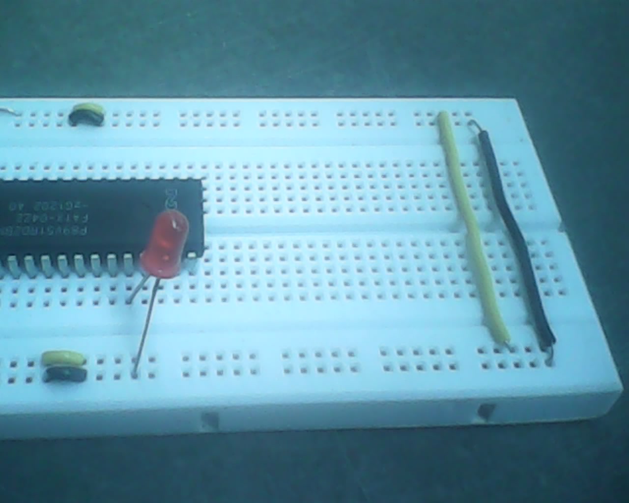

Spending almost zero time, the LED that you have is effectively shorted out and therefore useless. I don;t know what the specs of the ports on that chip is, but you need to make sure it can source or sink about 10-20 mA and size the pull-up or pull-down resistor appropriately.
R<= (Vdd-Vf-Vs)/Iled
where Vdd is the power supply voltage. Vf is the LED forward voltage (varies by color) and Vs would be Vc-e(sat) for a bipolar transistor. It's basically the voltage loss when the transistor or FET is fully turned on. I led is the operating current in AMPs.
The breadboard capacitance COULD affect the ability for the oscillator to work. Not saying that it will, but it is a potential problem.

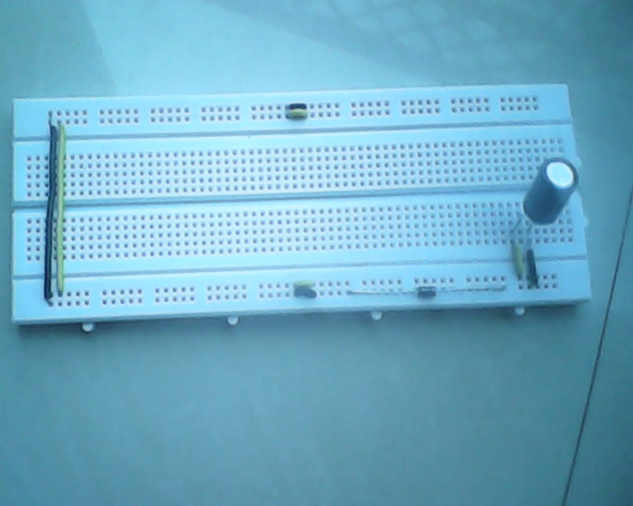

I will implement circuit on pcb later First I want to check out that my circuit is working properly or not , so first i am using breadboard

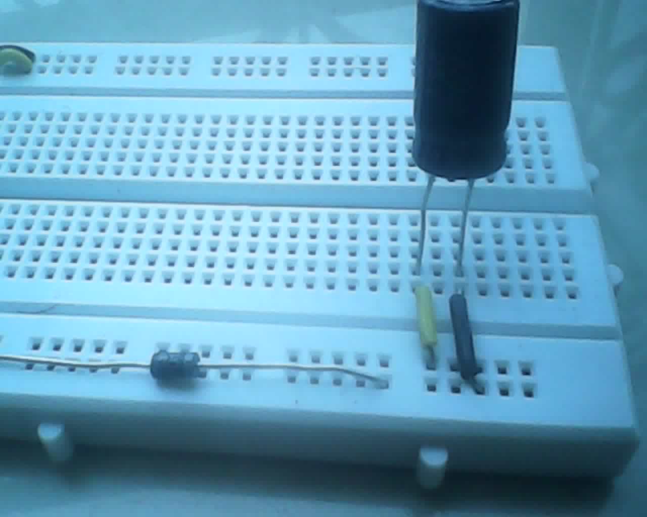

check out connection for capacitor and diode
black wire - ground
yellow wire - 9v dc

I THINK the yellow wire is connected to the (-) side of the cap.
I can't tell where the diode band is.
The diode is useless where you have it connected.
Breadboards like you have have generally two configurations.
1) Requires the jumpers you have placed horizontally.
2) Does not require the jumpers.
The edge top and bottom rows are ALL connected together and may or may not be in 8 (like you wired it) or 4 busses.

If you take an ohmmeter and place it across your diode, you will find it shorted in both directions.
The diode mode will also work. It will show 0 volts and beep.
You have your crystal capacitors connected to the red wire of the battery, they should connect to the black one.

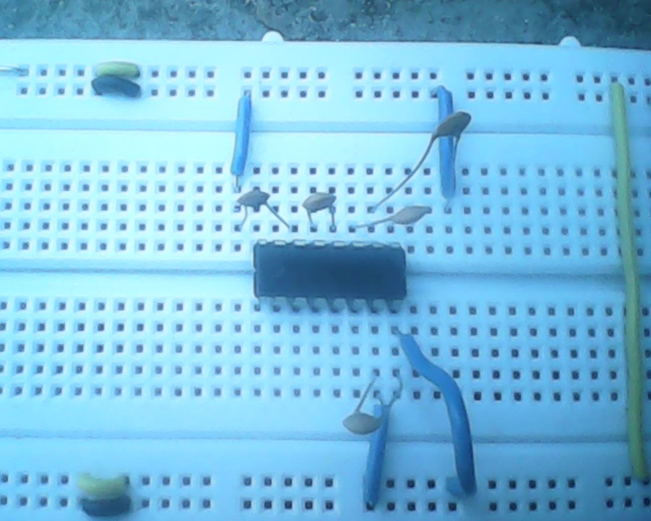

look at this Images for capacitor connection with max rs232 Ic
yellow - 5v dc
black - ground

TheRS232 seems to be... But your power supply isn't...
You are using the same chip as I have done in the tutorials..
which tutorial are you talking , do you mean 8051 in electro tech forum
I made power supply with microcontroller look at post #7
and now I want to add max rs232 chip on board so I made capacitor connection . I just want to confirm that connection is correct or not
Do what I said earlier. Take a multimeter and use either ohms or the diode scale and measure the diode in both directions in and out of circuit.
The breadboard is shorting out the diode. All of the 4 rows of pins in the horizontal direction at the edge are connected together because of your 4 jumpers, so the diode does nothing. The diode has to use one of the vertical tie-points.
I have taken reading in both direction its 2.0 ohms and 1.7 ohms

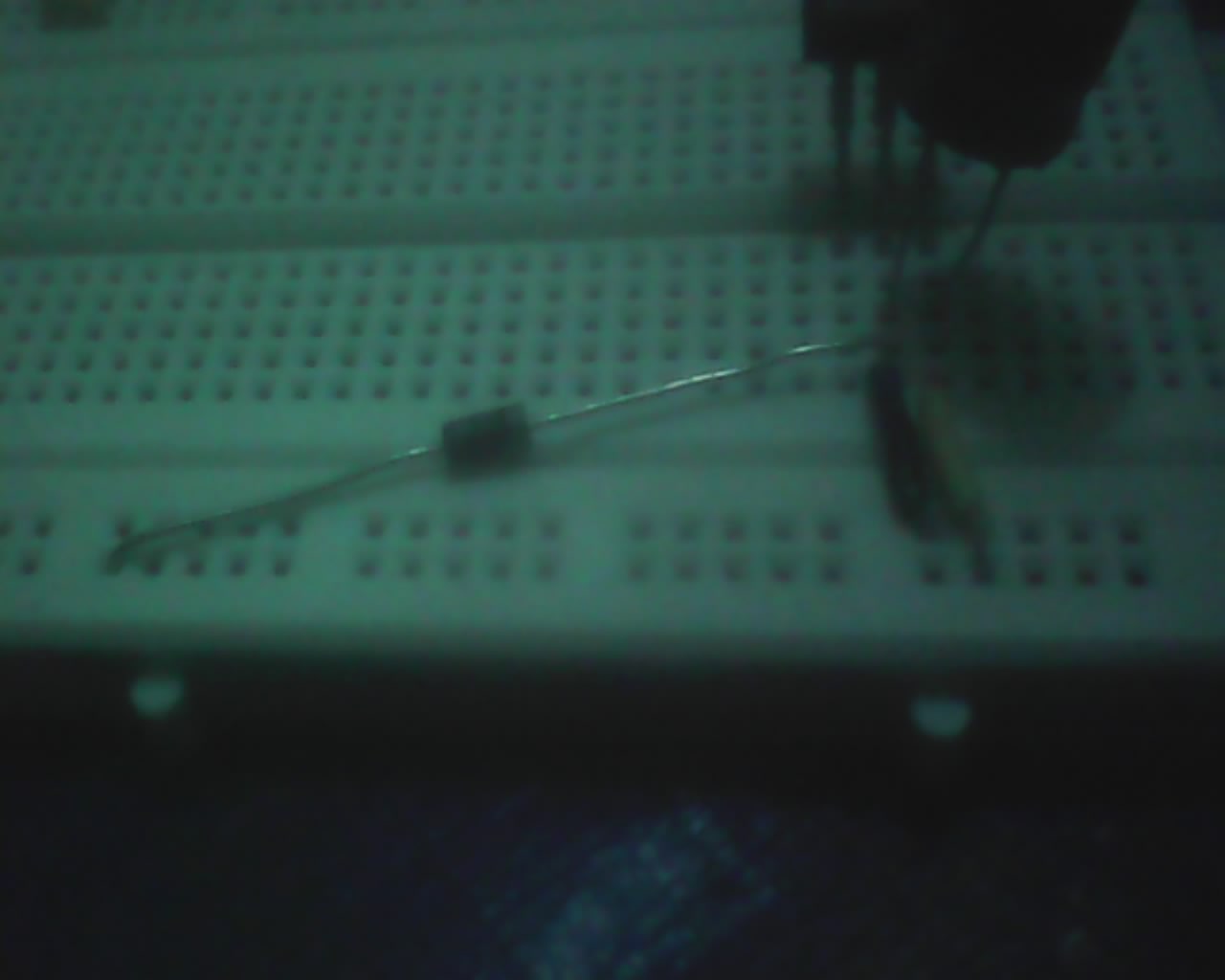

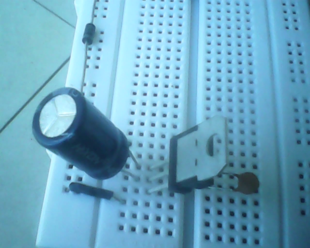

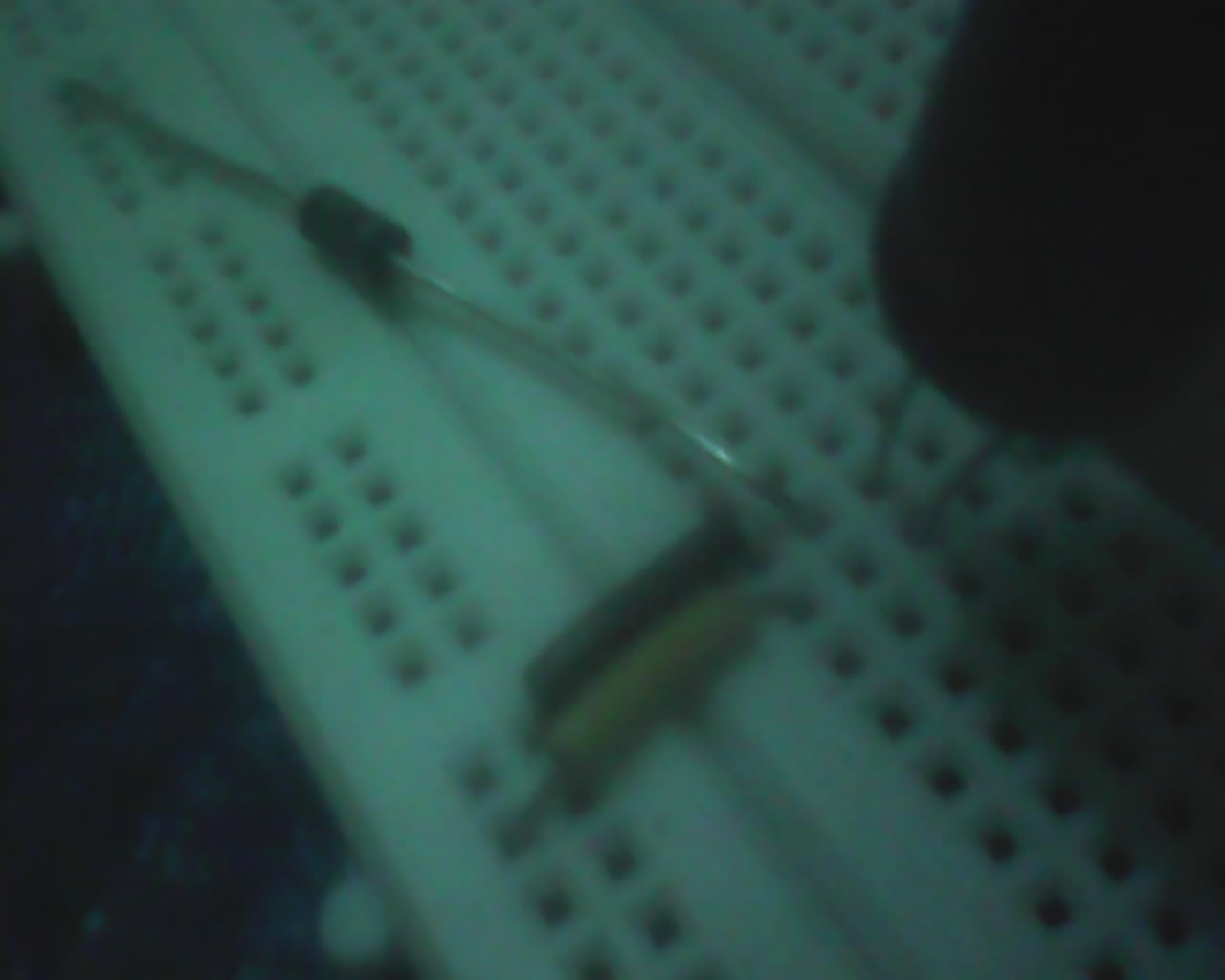

now i have connected positive terminal of diode to yellow wires and negative terminal with black wire that is negative
i have upload Image and sorry for bad quality of picture

If those diode readings were out of circuit, the diode is bad.
Per your schematic, the diode is supposed to be in series. You have it in parallel.
I have a hard time seeing the diode band, so I cannot comment on the direction.

that means i need to connect in series
I understood the one end of diode should be connected to 5v yellow wire and other end should be connected to the positive end of capacitor
