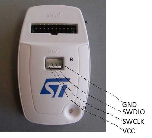

Thankyou. Would i be correct in saying that its the "J-LINK OB" connector in the bottom LHS that is the programming connector?
We dont have room on the PCB for a programming header or connector.....we only have room for bare programming pads on the bottom side, either SMD or PTH. Do st.com offer any pogo pin connectors for such a setup?
The below programming lead looks like what they must have been using on the PCB that i am updating...i can see 6 pads on the pcb and this connector looks like it contacts to such a SMD pad array.....but i cant find the part number or datasheet for the below...do you know it?

Please, do you think that the attached is the pinout for programming the STM32F042K6T6 micro from the ST LINK/V2 programmer?
