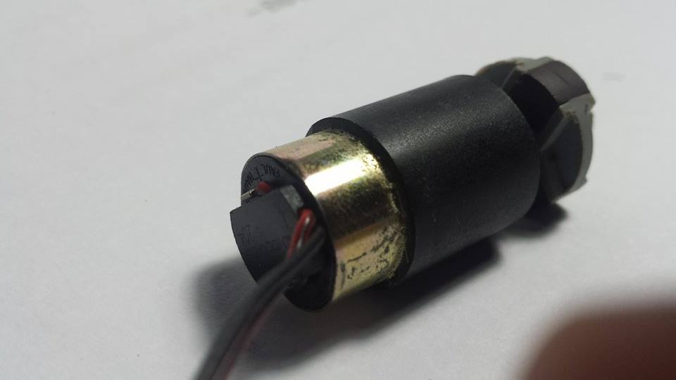

Thnx. This and old infusion pump motor. i want to operate the motor by programming it with less components and use the same level driving .(mm/hour)

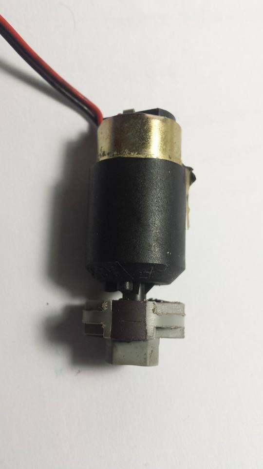

Its a small stepper motor used in this pump and there is an attachment with a pulley (with three magnets)attached to the rotor. In the old system there is a reed switch near the pulley to detect and reed the rotation which i believe.
i want to make it as compact as possible. but would like to see if could be done with arduino also. the pic of motor is below.

Are you certain it is a stepper motor? There are only two wires.
What rate does the motor run now? X mm/hour?
im not sure if is stepper or not. It run on 9v currently. The whole pump i mean.
it runs as mentioned as 1mm/hour until 12mm/hour(can be choosed either from a small selector switch, like a potentio meter)

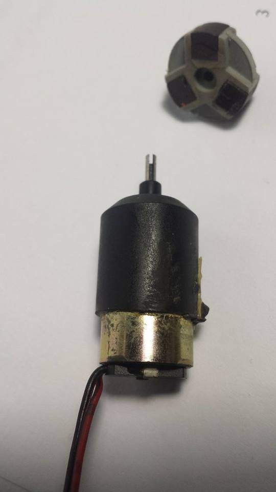

It does not appear to be a stepper in the traditional sense. it would not need the external magnets on the rotor?
Max.

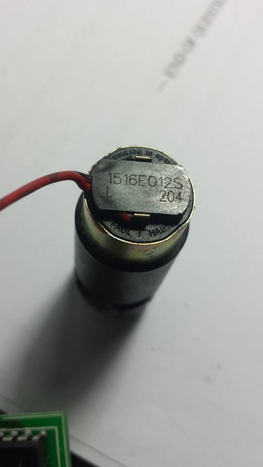

That is a normal DC motor from Faulhaber and as you do not have a encoder on the axis it is impossible to make it move an exact amount of rotation of the axis. Even having a reduction gear in front and applying a ms voltage the motor will never stop always at the same rotated degrees.
Motor 15mm diameter and 16mm long https://fmcc.faulhaber.com/details/overview/PGR_1082_13818/PGR_13818_13813/en/GLOBAL/
Gearhead possibly 204:1
Looks like a quite old model and so far I assume it runs well at 12V
A stepper motor would have either 4 wires = Bipolar or 5 to 6 wires = Unipolar
You can test it by applying 3V or 6V or 9V or 12V continously and see how many rotations it makes in a certain time.
It looks like you have a 12 volt motor.

The previous motor pics i uploaded are the motor pic from the old pump. thats how it looks. on this rotor there is 3 magnets attached as shown in the pics. then in the pump circuit there is a reed switch to reed or to off the circuit some how.
any ideas guys.
It would seem that it is a DC motor that uses the magnets and reed switch to move the measured distance by issuing a pulse until the switch is seen by the next magnet, you would need a processor to monitor the clock and issues to pulses as required.
My assumption is it operates on this step principle.
