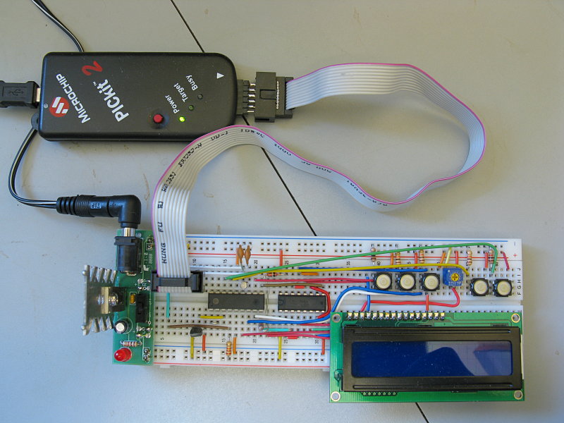

Just use a **broken link removed**. Simple, inexpensive and flexible. Excellent for experimenting and prototyping. For lots of photos and examples, have a look at my site.
This one is getting a tad crowded. :D I have bigger ones...
The PICkit 2 (Junebug too) can program/debug almost the full line of PICs.
