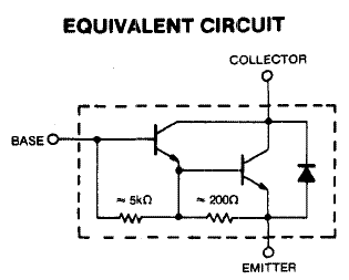

In the darlington pair, I see there are two resistor built in. Each of the transistor has one resistor across the base and emitter as attached.
So the 200 :eek:hm: resistor is used for the purpose that we were discussing, then what about the 5 k:eek:hm: resistor? Same purpose? To prevent any leakage current to the base of the transistor to turn it on?
