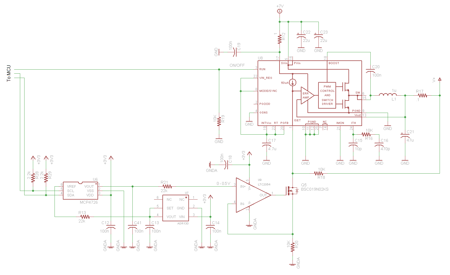

Hello again. I’m having some difficulty with a project I’m working on, and I’m hoping someone can help me find a solution.
I’m attempting to use the LTC3623 as a programmable current source by replicating the circuit shown here:
http://www.linear.com/solutions/7390
My test circuit is slightly different but I believe equivalent to the schematic shown at the link above. I’ve replaced VSHUNT in the lower left hand portion of the schematic with an ADR130 0.5V precision voltage reference and a 1kΩ potentiometer. I attached another schematic showing the modification I made highlighted in red. Everything else in the schematic is the same.
My problem is that the circuit isn’t working at all. Right now I have it connected to a supply voltage of 6V, and a load of .22 Ω. No measurable current flows for any potentiometer setting and when I measure the output voltage it's around 10 mV. When I remove the .22 Ω load resistor and measure the output voltage, it’s around 100 mV and only changes about ± 10 mV over the full adjustment range of the potentiometer. Obviously this is not what I expected because I used the same op amp, MOSFET, and component values shown in Linear’s schematic.
So naturally I have a few questions:
  • Correct me if I’m wrong, but the MOSFET symbol shown in the schematic is for a P-Channel MOSFET, yet the part number called out (BSC019N02KS) is for an N-Channel Power MOSFET. Can anyone infer enough about what is going on in this circuit to say for sure whether that MOSFET should be N channel or P channel?
  • Also, the MOSFET called out in the schematic is for a pretty beefy SMD MOSFET rated for over 100W. I can’t figure out for the life of me why that would be necessary. Can anyone shed light on that?
  • I have the LTC2054 op amp V+ connected to 3.3V and V- connected to ground. I have also tried it with V+ connected to the same 6V supply as the LTC3623. Both configurations yielded equally unsuccessful results. Does anyone know how I should connect the LTC2054?
  • Can anyone see any problems with my test set up or potential issues that I didn’t address?

Hy VNE,
The MOSFET symbol shown on the data sheet is an alternative symbol for an NMOSFET. The circuit function does require an NMOSFET as you say.:)
spec
It does appear to be an extraordinarily hefty NMOSFET for the job required, but it has a very low gate threshold voltage (1.2V), a very low on resistance, and unusually low drain leakage current (1uA) and those are the characteristics that are required, rather than the high maximum drain current. Also, although the NMOSFET has a very high current capability, it only has a maximum VDS of 20V. MOSFET performance has improved radically in the last few years and there are now smaller NMOSFETS that would do the job.
One possibility is that the NMOSFET is oscillating at a high frequency: try putting a 47 Ohm resistor (gate stopper) physically on the gate terminal of the NMOSFET and in series with the opamp output.
Another possibility is that the feedback loop, around the NMOSFET and opamp is oscillating. This may be due to the layout of your circuit and lack of decoupling. A 100nF ceramic capacitor is needed across the supply pins of the opamp.

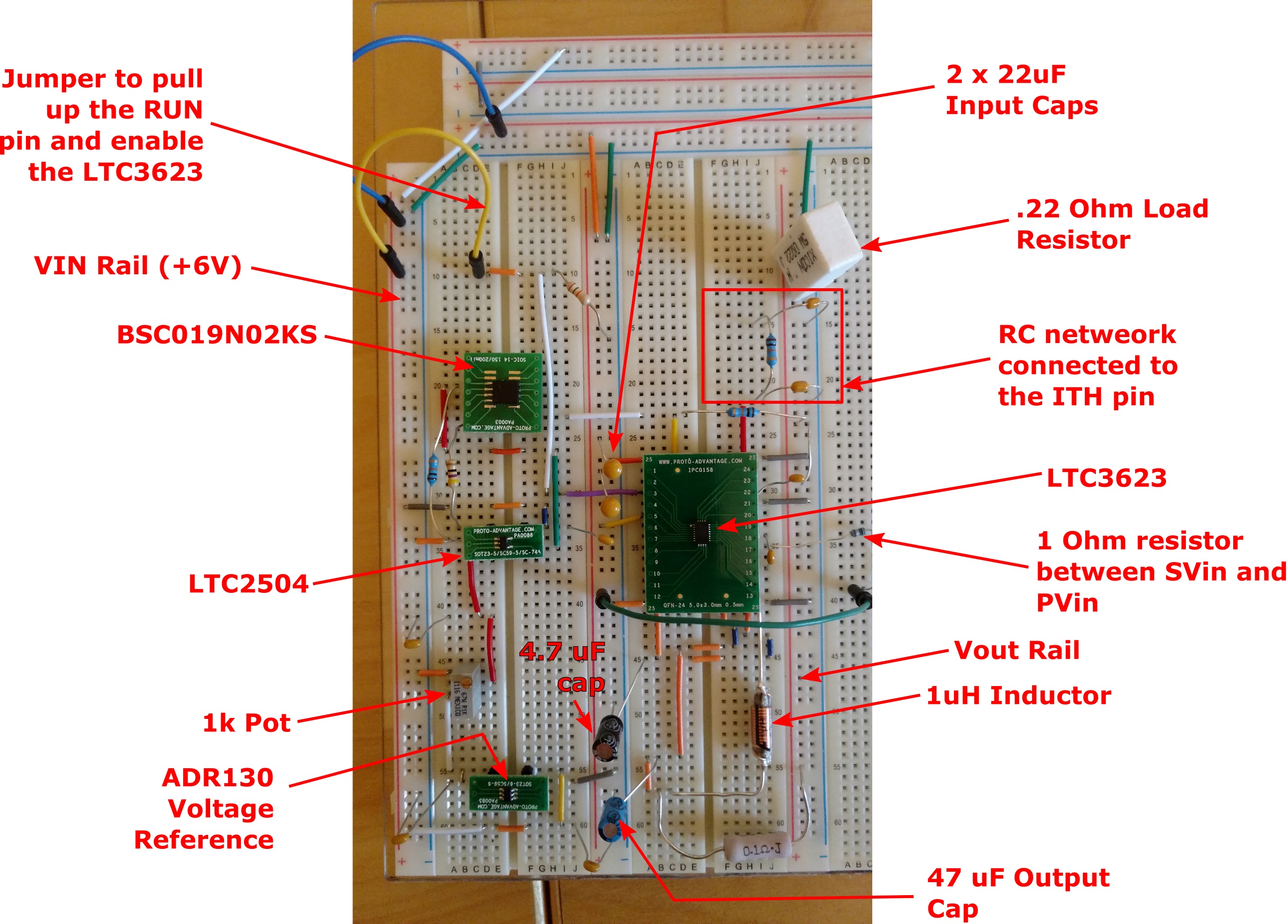

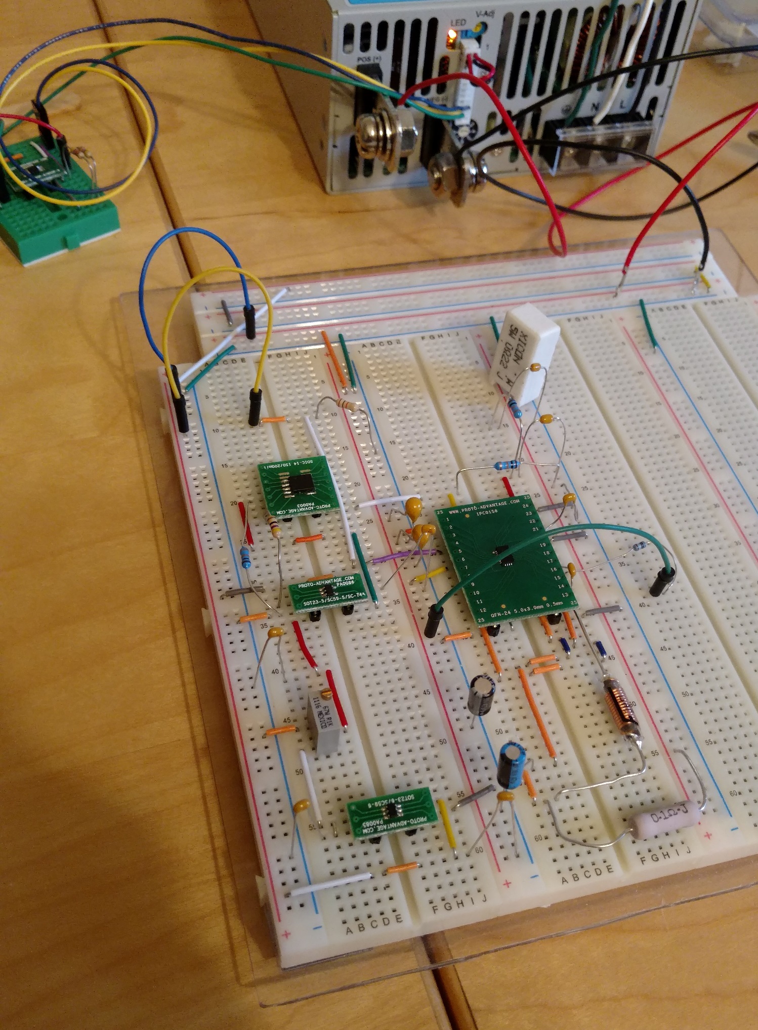

Can you post a picture of your circuit so that we can see the layout?

Here are some pics. I'm still working on doing the test you recommend and answering the other questions.

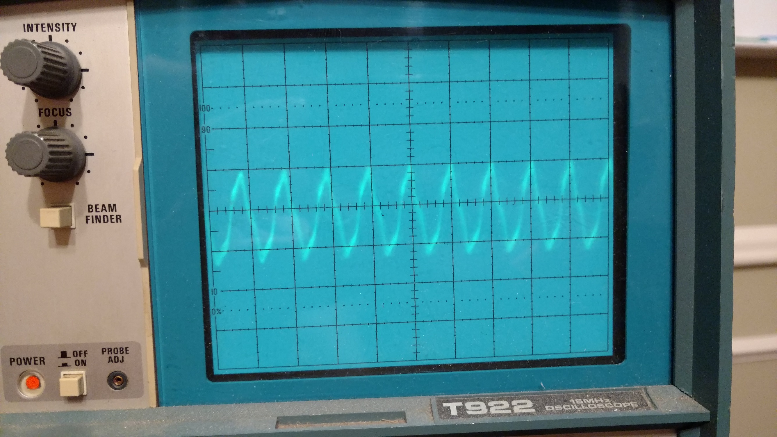

Solderless breadboards are notoriously problematic for high frequency switching power circuits.
They have stray resistance, inductance and capacitance that just plays havoc with noise sensitive feedback circuits in switching power supplies..
I suspect that if you looked at the SW node with an oscilloscope you'd see a very narrow pulse at the switching frequency. Narrow, because the pulse gets terminated the instant that it turns on due to the parasitic resistances, inductances and capacitances of the breadboard.
Afraid that ChrisP58 is correct in post #14.
If you look at the pictures in the application report you will see that a ground planes and a compact layout are used.

I connected my oscilloscope to the SW node as you mentioned and attached a picture. The time scale was set at .5 μs/div, and the Y scale was set at 5V/div. My oscilloscope is pretty old so that settings aren't exact, and that was the best picture I was able to get, sorry.
Analyzing the waveform though, it seems to be around 1 MHz which is what the datasheet says the frequency should be after connecting the RT pin to the INTVCC pin.
Is the shape and magnitude of the waveform what you were expecting to see? In other words, is it consistent with what you suspect is going on?

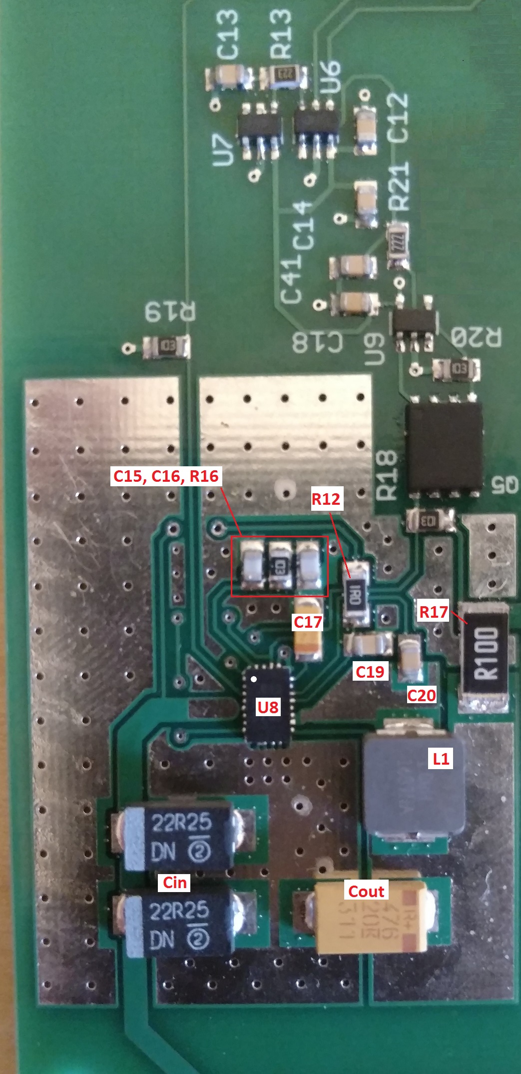

In my PCB design I'm using a ground plane, and the layout is as compact as I could make it. I tried to follow the recommendations in the "Board Layout Considerations" section as closely as possible. This likely futile exercise at bread boarding the circuit was just my attempt to ensure I didn't need to go through several expensive iterations of having the PCB fabricated.
In other news I made a little progress last night. By changing the layout slightly, I was able to get at least a little output from the LTC3623. In my mind this adds credence to the bread board being the issue. The output current wasn't was it was supposed to be based on the potentiometer input and the datasheet but I can tell that the circuit is at least doing something. I wouldn't be surprised if my problems are in fact related to the bread board alone.
With that in mind, can either of you recommend some extra footprints I should design in for fine tuning later? What I mean is I can design it with caps and resistors out the wazoo and then add them if needed after the board has been made. If I don't need them, I'll just leave an empty footprint or use a 0 Ω jumper resistor.
Based on Spec's suggestion I'm already going to design in a resistor footprint between the gate of the NMOSFET and output of the op amp. That wasn't shown in the schematic and as a result, it wasn't originally part of my circuit. After the board is made I'll add a 47 Ω resistor there, or if I end up not needing it a 0 Ω jumper resistor instead.
Can you suggest anywhere else I should employ the same approach?
Lastly, with respect to the supply to the op amp, should this be the same 6V supply for the LTC3623, or can I run it off of 3.3V instead?

Sorry for the slow response. I've been pretty heads down in this project. I did the test Spec described and it checked out. Based on that, I felt fairly confident that my problems were related to the solderless breadboard and I went ahead with having the PCB fabricated. After assembly of the custom PCB that I designed using the layout considerations outlined in the datasheet, the circuit works. Well, it sort of works.
I can control current output, but only down to about 0.9A. An input voltage of 400 - 500 mV yields ~ 0.9A. If I go below 400 mV, the output current begins linearly increasing to about 4.75A at 0V. But if I go above 400 mV, the output never decreases below 0.9A. In other words, I'm bottomed out at 0.9A.
Does anyone know why I can't get below 0.9A? Is this some limitation with the circuit that wasn't described in the datasheet, or that I neglected to understand? If not, any suggestions on how I can get to lower output currents (change output capacitor, switching frequency, inductor, etc)?
In my application I need to be able to current limit down to about 90 mA.
Also, and unsurprisingly, at the higher current levels it gets pretty hot. I think I'm going to need a second iteration of the board just to address that. So any suggestion on how to improve heat rejection would be appreciated as well.
I attached the relevant portion of my circuit schematic and a photo of my assembled PCB.
Thanks!
For minimum current output, all the current of the 50uA source in the IC needs to pass through the FET. Given that the rated Vgs(thr) for the specified FET is ~1V, that means the opamp needs to drive the gate with at least 1.5V in theory. If for some reason either the opamp or the FET were out of spec that could account for the effect you are seeing. Can you try supplying the FET from 6V instead of 3.3V?
