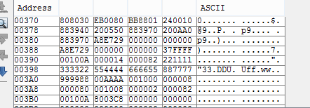

I have written the following program to program flash memory with data. I have tried to simulate the code before actually flashing the code but i am not seeing the data as expected. Please help.

When i simulated i got the following details in the variables section
So i am assuming that the variable data_in_flash is placed at the address 0x0103B4. Am i correct? Then i opened the program memory window and i see the following information
the data seem to match but not in proper order with what ever i am trying to write, but does not seem to be writing in the address i am expecting. Please help.
