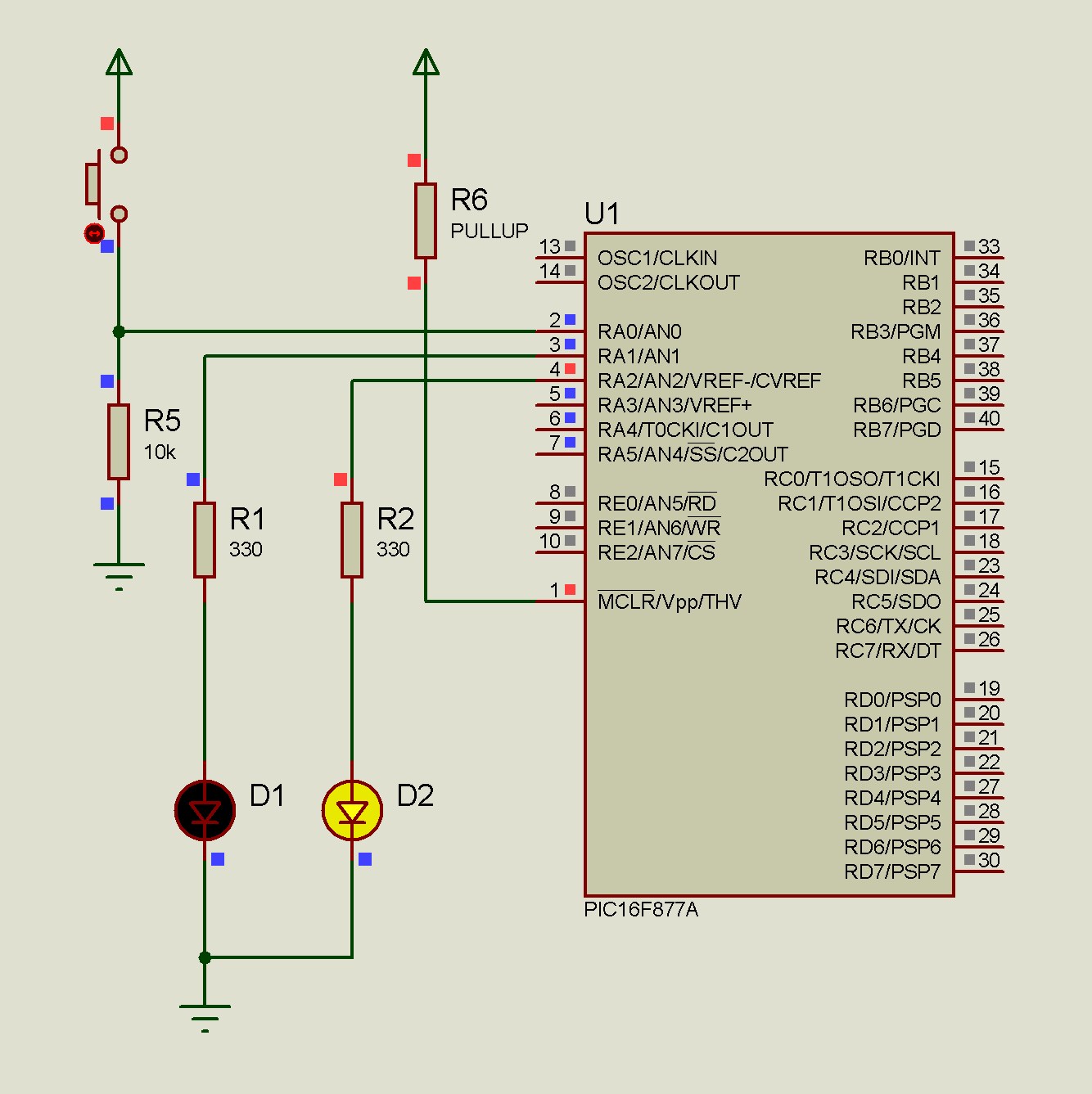

I have been reading a lot of tutorials the last days and i have managed to write a program for a dual blinking leds with switch .
I have completed the program using the C language , but when i load it on the PIC16F877A it does not apply it .
Here is a copy of the program :

What configuration settings are you using at the beginning of the program? Show complete program please
In mikroc , am using 4Mhz , PIC16F877A when i first started new project , that all i was asked to configure .
That's the complete program straight from MikroC

Add in the line as indicated by the arrow and see if it works.
If it doesnt, put a 10K resistor from pin 1 of 16F877 (MCLR) to +5V and try again.

OK, then put a 10K resistor between RA0 and ground. Your switch input is floating.
Allen
I don't know what the fxxxxxx is wrong , program is compiled and nothing works , her is what i get when i want to compile the original tutorial program !
The "else" statements are in the wrong brackets
else{led_1=0; led_2 = 0;} // curly brackets

Even when i apply 5 volts to the MCLR/ , nothing happens , the program is running fine but the PIC on ISIS does not run it
are you using the internal oscillator or external??
if external than you have to connect it to the hardware in ISIS
No you don't..... It isn't simulated... You don't need to put it in...

I converted your program to HiTech C and it works on the ISIS..
The converted program as attached
#include <htc.h>
#define _XTAL_FREQ 4000000
int i ;
#define sw RA0
#define led_1 RA1
#define led_2 RA2
void main () {
ADCON1 = 6;                //make port A digital
TRISA = 0b00000001 ;    //ra0 input, ra 1&2 output
while(1) {
if (sw == 1) {
for(i=0;i<=5;++i){
led_1=1 ;
led_2=0 ;
__delay_ms(1000) ;        //one second delay
led_1=0;
led_2=1;
__delay_ms(1000);
else { led_1=0; led_2=0; }
I also attached the isis sim and the hex file. You may try my hex file and see if it works on your ISIS and hardware circuit.
