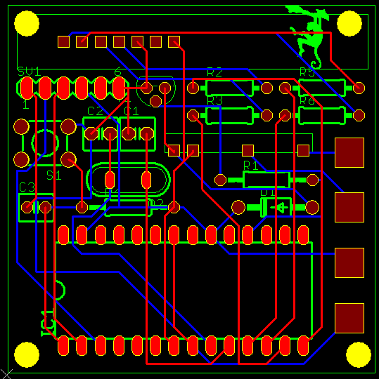

1) How did you get rid of the layer abuse errors I was getting on the four large pads?
2) When I do a DRC I get "Stop Mask" errors. What are these please?
Thanks!

Yes. I too got the mask related errors, Later, i enabled, under Display, only following items.
" Bottom, Pads, Vias, Unrouted, Dimention, tPlace, tOrigins, tNames and tValues"
It helped me overcome that error.
I called the "gerb274X.cam" for the conversion, the process was no error.
In addition, you need to call “excellon.cam” generate a “board.drd” file for drilling. I have seen are more inch's. Gerber as well.
